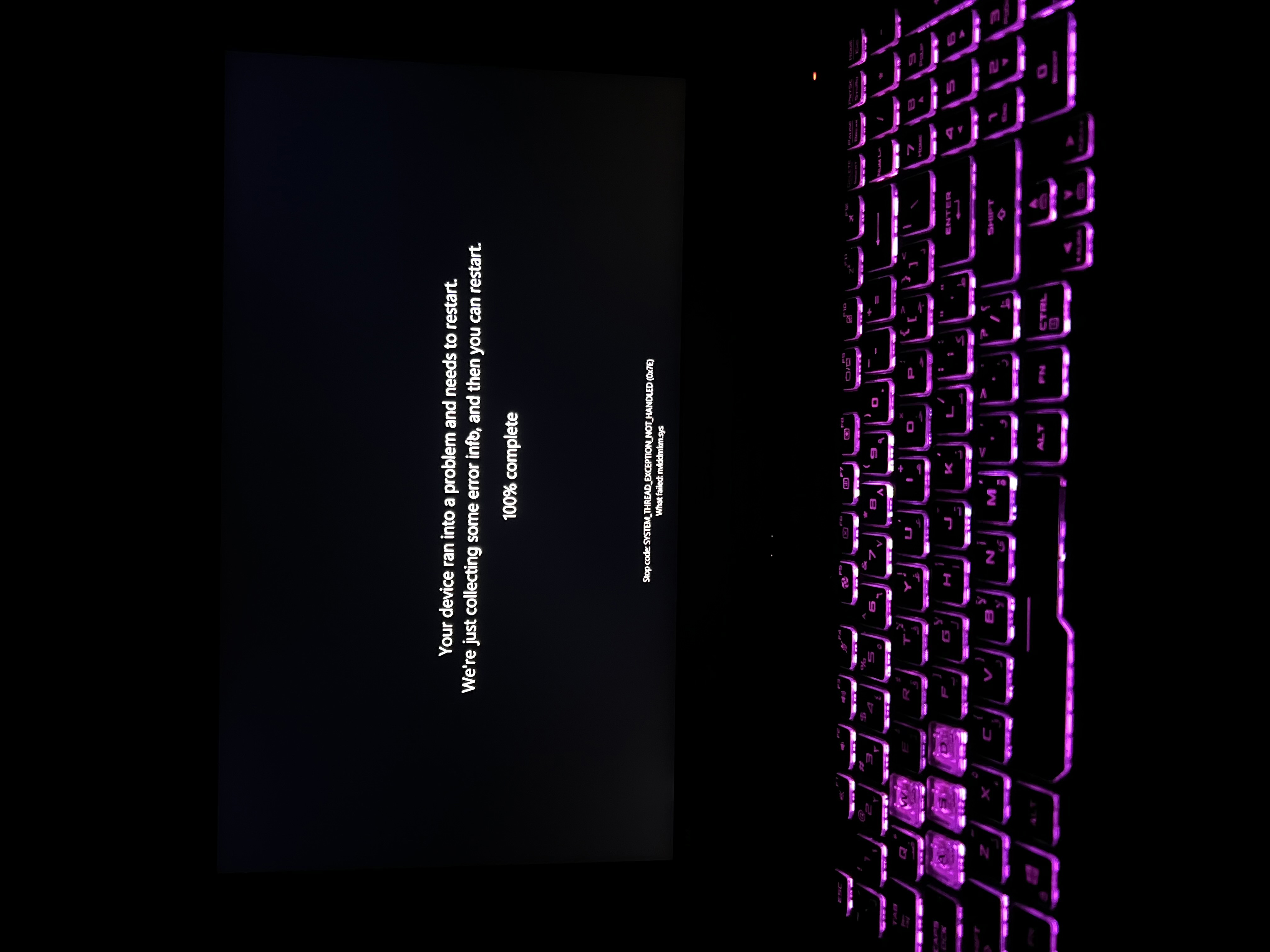

WONT SWITCH ON AFTER THIS / Stop code: SYSTEM_ THREAD_EXCEPTION NOT_HANDLED (0x7E) What failed middinkm-sys

    Your screenshot indicates it is the Nvidia graphics driver (nvlddmkm.sys) causing the black scree.

    The stop code SYSTEM_THREAD_EXCEPTION_NOT_HANDLED (0x0000007E) means a system thread raised an exception that Windows couldn’t handle. In the message, middinkm.sys is the driver that failed.
