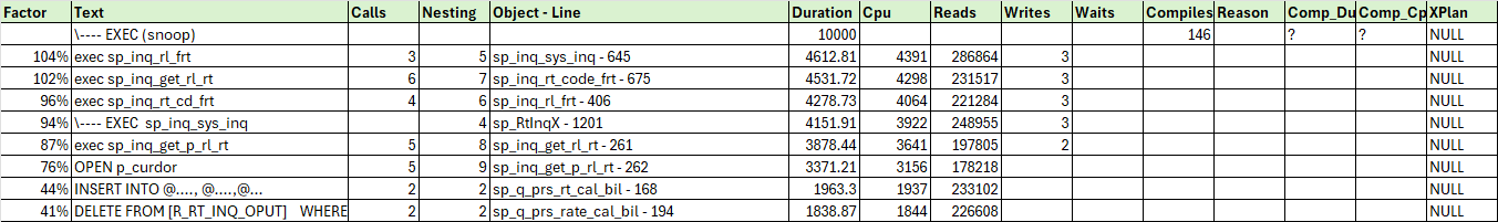

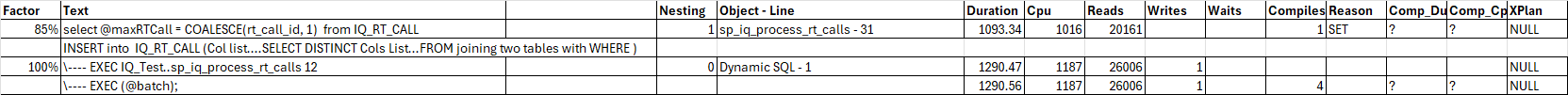

    Assuming that your code is running loops, a very good tool to troubleshoot this is sp_sqltrace, originally written by Lee Tudor, and which I am happy to host on my web site. You can simply say:
    EXEC sp_sqltrace 'EXEC slow_sp', @order = 'Duration'
    And it will start a trace, filtered for your spid, capture sp_statement_completed. When slow_sp has completed, it will analyse the trace, and if the same statement is executed multiple times, the data for those executions will be aggregated into a single row. The statement(s) that gets to the top is one you should look into. Beware that if the procedure runs for more than five minutes, you need to adjust the @trace_timeout parameter, because by default the trace stops after five minutes.
    Then again, maybe you don't need the data from the full execution. You can also say:
    EXEC sp_sqltrace 77, @order = 'Duration'
    sp_sqltrace will now set up a trace filtered for spid 77 (or the spid where the slow procedure is running), and run that trace for 10 seconds (adjustable with the parameter @snoop_time) and then perform the aggregation.
    You can also use sp_sqltrace to capture execution plans, would that be needed.
