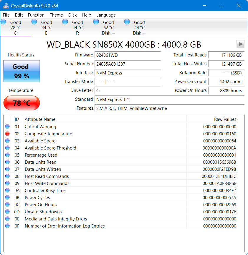

for the last two or three months i have been seeing multiple Event ID 52 (source: Disk) events in the windows event logs (System). the nature of the event is very concerning. the details are as follows: The driver has detected that device \Device\Harddisk0\DR0 has predicted that it will fail. Immediately back up your data and replace your hard disk drive. A failure may be imminent.
the drive in question is a WD_Back SN850X
naturally i was alarmed to see such a message, however..... the drive in question is less than two years old, and all diagnostic data i can get from the drive from WD (WD Dashboard) and from CrystalDiskInfo app all seem to say that there is nothing wrong with the drive. All indications are the that drives health still very good, with the drive condition at 99%. there are no reassigned sectors or bad blocks. the spare blocks reserved for when sectors do go bad is still at 0 used. I even ran 'Chkdsk /v/ /x /f /r /b' which took forever, but found no errors (when i looked at the results in the event log)
am i seeing erroneous errors? do i need to be concerned?

From Crystaldiskinfo:

    I checked the image you provided, and the SSD temperature is extremely high. This high temperature is likely the reason why Event ID 52 is being triggered.
    The operating temperature range of the SN850X is 0°C to 85°C. However, in practice, thermal throttling can occur once the drive exceeds around 70°C, and this may cause Windows to mistakenly report a “predicted failure.”
    Do you have a heatsink installed on the SSD? If you do, please review the airflow inside your PC, as insufficient airflow can prevent the SSD from cooling properly.
    In addition, if the SSD is reaching temperatures near 80°C, your CPU or GPU may also be running hotter than expected. I recommend checking the overall cooling performance of your system.
    Once you improve the cooling and the SSD temperature stabilizes around 50°C, please check again to see whether Event ID 52 continues to appear.
