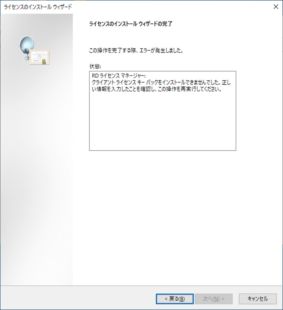

I would like to ask for guidance on how to change the license program.

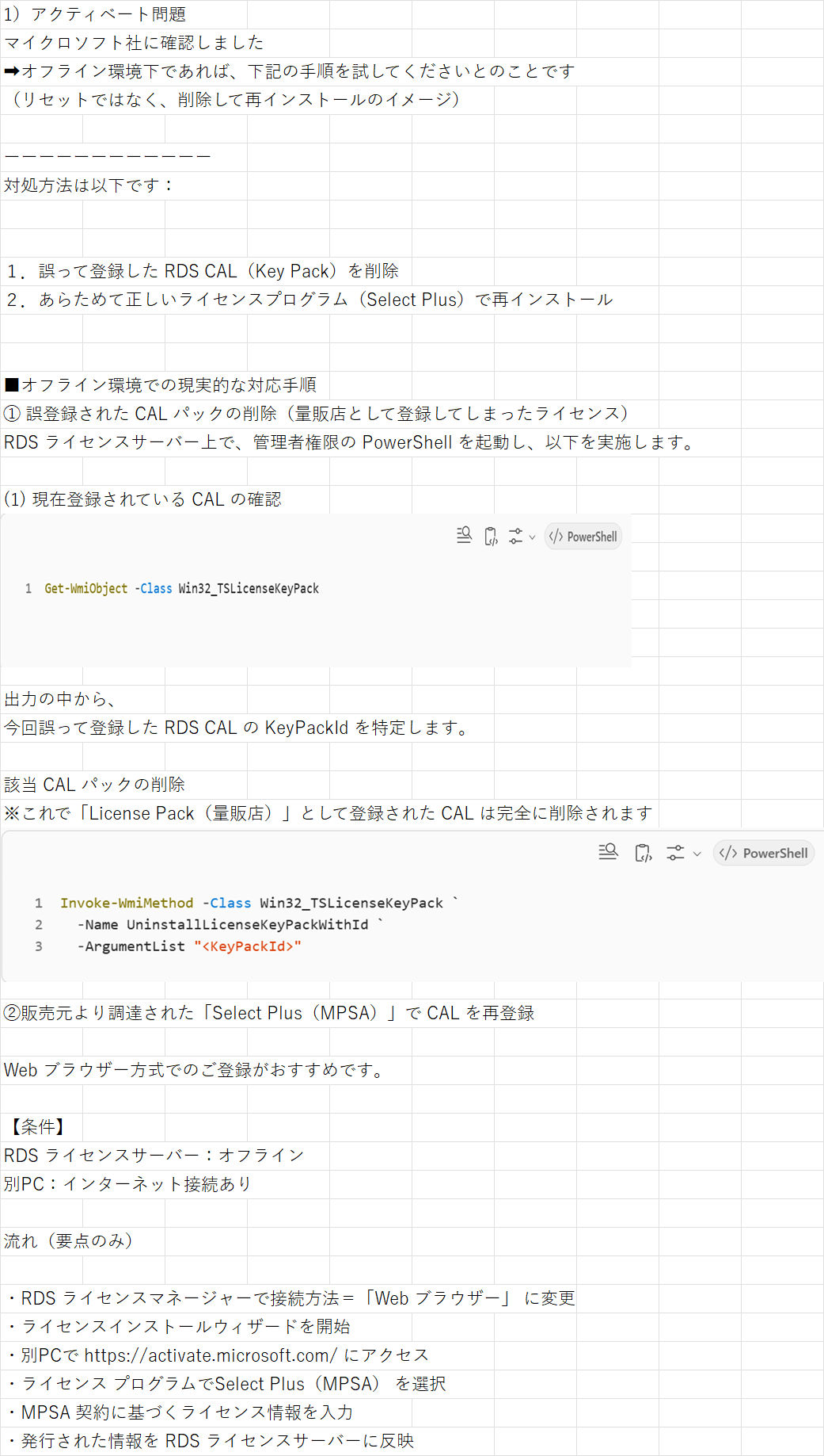

The steps shown in the attached file, “0318_MS Response,” were provided by Microsoft when we contacted them on March 18.
However, I believe those steps apply only when the license is already installed.
As shown in the “Current Status” sheet of the attached Excel file, the license we want to remove is not currently installed.
Therefore, I would appreciate your guidance on how to reset the license program under this condition.

Error message:
“The client license key pack could not be installed.”
We apologize for the inconvenience and would appreciate your support on this matter.
エラー画面User's image

    You are correct in your understanding: the steps provided earlier mainly apply when an incorrect CAL pack is already installed. In your current scenario, since no license pack exists on the server, there is nothing to uninstall, and the issue is more likely related to how the license program is being interpreted during installation.
    In this case, I recommend focusing on the installation method rather than attempting a reset. Please ensure that when running the RD Licensing Manager wizard, you explicitly select the correct license program, “Select Plus (MPSA)”, and carefully input the Agreement Number (84154350) exactly as provided. Even a minor mismatch in program type or agreement details can trigger this error.
    Additionally, since your RDS license server is operating in an offline environment, I strongly suggest using the Web Browser activation method. This involves generating the request from the license server, completing the process via https://activate.microsoft.com/ on a separate internet-connected machine, and then applying the response back to the license server. This method avoids validation issues that often occur in offline scenarios.
