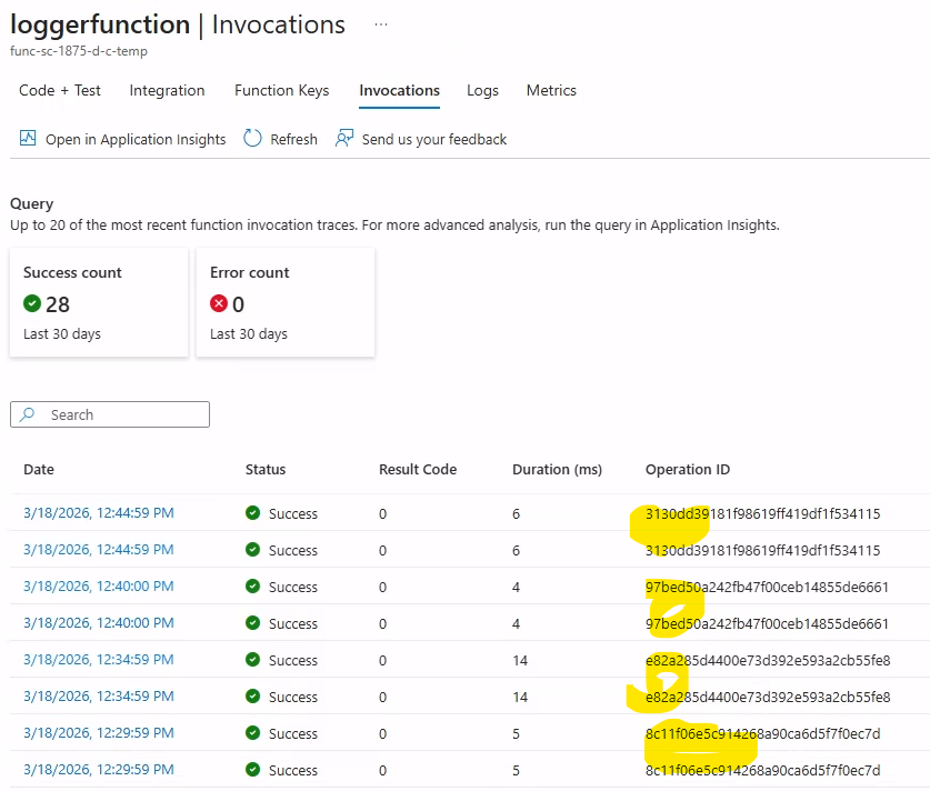

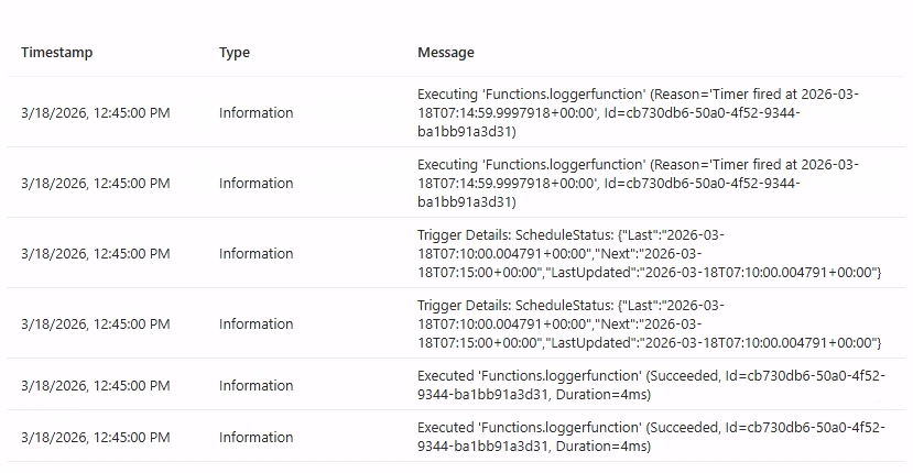

Hello,
I am using .NET 8.0 isolated Azure Functions with Application Insights enabled for logging.
App Insights is connected to a Log Analytics workspace.
Issue:
  • Each function invocation appears duplicated in Log Analytics.
  • Logs are duplicated for every run.
  • The OperationId and timestamp are identical across the duplicates.
Environment details:
  • Runtime: .NET 8.0 isolated Azure Functions
  • Logging: Application Insights → Log Analytics workspace
  • No custom telemetry initializers or sampling configured
Expected behavior:
  • Each function invocation should produce a single set of logs.
Actual behavior:
  • Duplicate entries are created in Log Analytics for every invocation.
Questions:
  • Is this a known issue with .NET 8 isolated functions and App Insights integration?
  • Could this be due to misconfiguration in the telemetry pipeline?
  • How can I prevent duplicate logs and ensure accurate monitoring?
Any guidance or confirmation would be appreciated.
Duplicate invocations
Duplicate Logs
Each Invocation Its duplicated logs
Azure Functions
Azure Functions

  1. Praveen Kumar Gudipudi 2,275 Reputation points Microsoft External Staff Moderator
    2026-03-23T15:57:35.2966667+00:00
    Hello Vigneshwaran Balu (EXT),
    your .NET 8 isolated Function is sending the exact same telemetry twice into the same Log Analytics workspace—once from the Functions host and once from your worker/App Insights pipeline (or once via App Insights→LA and again via a resource Diagnostic Setting). Because both pipelines stamp logs with the same OperationId and timestamp, you see perfect duplicates.
    Here’s how to eliminate the dupe:
    Pick a single ingestion path
    • Host-only integration (the default): • Remove any direct SDK calls (e.g. AddApplicationInsightsTelemetryWorkerService() / ConfigureFunctionsApplicationInsights() in Program.cs). • Keep your Application Insights connection string or instrumentation key in the Function App settings.
      • Worker-only integration (direct SDK in isolated process): • In your Function App’s Application Settings, remove the APPINSIGHTS_INSTRUMENTATIONKEY or portal-configured AI connection so the host doesn’t auto-stream. • Keep your AddApplicationInsightsTelemetryWorkerService() + ConfigureFunctionsApplicationInsights() calls in Program.cs.
        • Diagnostics-only (Azure Monitor Diagnostic Setting): • If you’re using the Function App’s “Diagnostics” blade to send FunctionAppLogs into your workspace, disable that setting and rely on the above AI pipeline instead.
        Double-check your settings
        - Ensure you’re not setting both `APPINSIGHTS_INSTRUMENTATIONKEY` *and* `APPLICATIONINSIGHTS_CONNECTION_STRING`. Only the connection string is preferred.
           - Confirm you don’t have a Diagnostic Setting on the Function resource sending *FunctionAppLogs* into the same workspace that App Insights is already feeding.
           Validate it went away Run a quick Kusto query in Log Analytics to find any ops with more than one record per minute:
           ```sql
           union requests, traces
    | summarize cnt = count() by operation_Id, bin(timestamp, 1m) | where cnt > 1 ```
               If you only see `cnt == 1`, you’ve successfully removed the duplicate stream.
    Follow-up questions if you’re not sure:
    • Do you have any Azure Monitor Diagnostic Settings on the Function App resource sending FunctionAppLogs/FunctionAppMetrics to the workspace?
    • Did you manually wire up Application Insights in Program.cs (with AddApplicationInsightsTelemetryWorkerService() / ConfigureFunctionsApplicationInsights()) and also set the AI key/connection string in App Settings?
    • Which Functions runtime version are you on, and what hosting plan (Consumption, Premium, Dedicated)?
    That should get you back to a single, accurate set of invocation logs.
    Reference docs: • Application Insights logs missing or incorrect: https://learn.microsoft.com/troubleshoot/azure/azure-functions/monitoring/functions-monitoring-appinsightslogs • .NET isolated process + App Insights guide: https://learn.microsoft.com/azure/azure-functions/dotnet-isolated-process-guide?tabs=ihostapplicationbuilder%2Ccode%2Clinux#application-insights • Troubleshoot Azure Function App Log Analytics: https://learn.microsoft.com/azure/azure-functions/monitor-functions-reference#supported-resource-logs-for-microsoftwebsites • Application Insights Duplicate logs deep dive: https://supportability.visualstudio.com/AzureAppService/_wiki/wikis/AzureAppService/1215633/Azure Function App/Monitoring resources, using metrics, logs and alerts/Application Insights/Application Insights Duplicate logs • Troubleshooting duplicate records in Azure Monitor Logs: https://learn.microsoft.com/azure/azure-monitor/logs/get-started-queries#why-am-i-seeing-duplicate-records-in-azure-monitor-logs
    Please accept as answer and do a Thumbs-up to upvote this response if you are satisfied with the community help. Your upvote will be beneficial for the community users facing similar issues.
