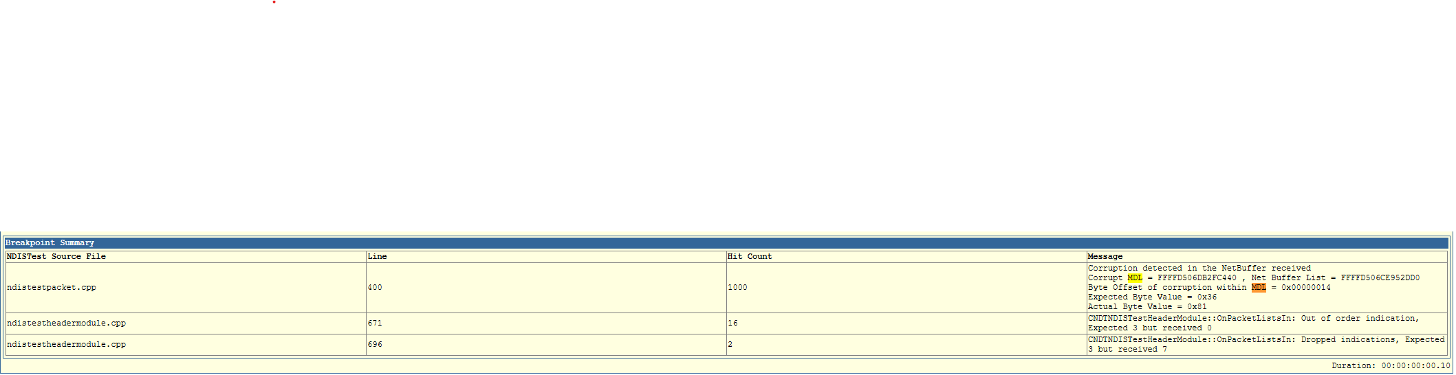

I’m facing failures in a few HLK network test cases using:
HLK Server: Windows Server 2022
Client systems: Windows Server 2025 / Windows 11
Issue Summary
The failures seem to be related to IPX packets being dropped, as observed via pktmon.
Observations
  • HLK is generating packets with:
802.3 + LLC/SNAP + IPX (0x8137) + payload
My network driver does not modify packets, it only parses LLC/SNAP headers.
In debugging (NdisProtocolTest.cpp):
  • The test checks packet type at offset 0x14, which aligns with IPX after LLC/SNAP.
If I truncate LLC/SNAP and pass:
802.3 + IPX + payload
  • → The warning in ndistest.cpp disappears → But upper layers still drop the packet as “corrupted”
Questions
Why is HLK still sending IPX traffic, given that IPX is deprecated in modern Windows?
Is HLK expecting drivers to fully preserve and pass LLC/SNAP encapsulation, even for legacy protocols?
  1. Are there any specific alignment, padding, or MDL requirements that HLK enforces for these packets?
Could this be related to known HLK test behavior or errata in recent versions?Hi All,

    Hi @David ambu , Thank you for your patience.
    This looks more related to how the packet is handled in the driver rather than the IPX protocol itself.
    HLK network tests use synthetic traffic, so the protocol isn’t really the focus. These tests are exercising packet handling, where the frame is expected to be passed up as-is, including the full 802.3 + LLC/SNAP encapsulation. If anything is modified, truncated, or misaligned (NET_BUFFER offsets, MDL layout, length, etc.), the stack may fail to parse it and drop it as “Unsupported EtherType.”
    The LLC/SNAP behavior you mentioned is a useful signal since removing it changes the result but leads to corruption, that typically points to an issue in how the original frame is being passed through rather than the protocol itself.
    It might be worth double-checking these on the receive path:
    • Full frame preserved end-to-end
    • NET_BUFFER DataOffset/DataLength
    • MDL chain covers the entire buffer
    Comparing the packet at the hardware/miniport edge vs what’s indicated to NDIS should help pinpoint where things diverge.
