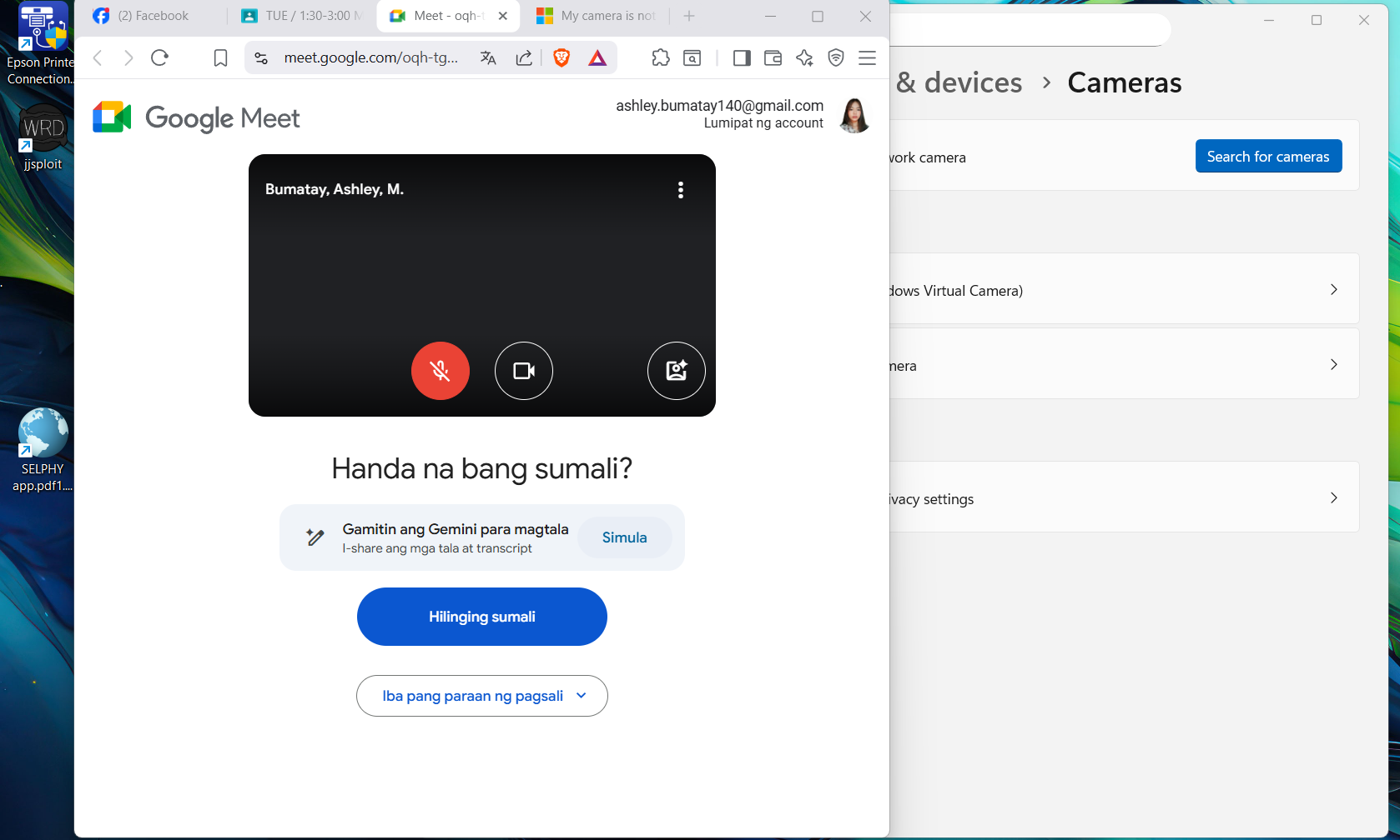

My camera is not working and is not showing up under Devices. It says that No Cameras are Attached and We can't Find your Camera. Error Message 0xA00F4244

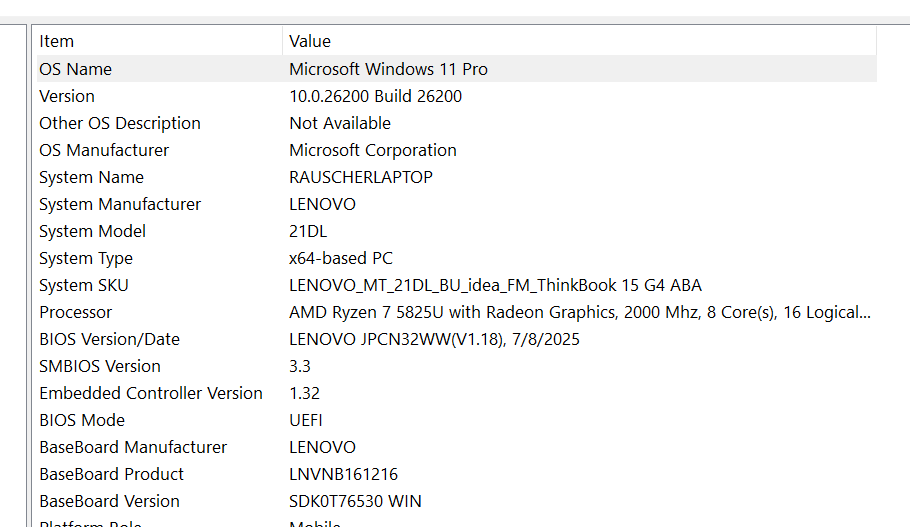

    If you prefer, you can share a screenshot of your system information.
    • Press "Windows + R", type msinfo32 and press Enter.
    Maximize the window and use the shortcut "Windows + Shift + S" to use the screenshot tool.
