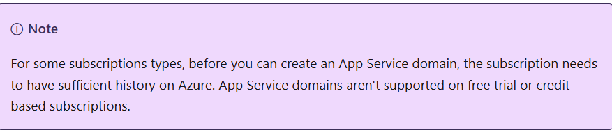

    Although Pay‑As‑You‑Go is a supported subscription type, new subscriptions may not yet be eligible to purchase App Service Domains. For some subscription types, Azure requires sufficient billing or usage history before allowing domain purchases. There’s no portal setting or manual option to enable this behavior, and it can’t be overridden.
    The good news is that you’re not blocked from using a custom domain. The recommended and fastest solution is to purchase the domain from an external registrar (such as GoDaddy or Namecheap) and then map it to your Azure Static Web App. This approach is fully supported and commonly used.
    If you have access to another Azure subscription in the same tenant with established billing history, that subscription may be able to purchase the domain instead. Otherwise, using an external registrar is the most reliable option.
