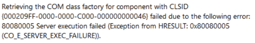

Hi guys, I’ve built a custom add-in for Microsoft Word and tried deploying it on a Windows machine, but I’m running into issues getting it to actually run after installation. I published the add-in and installed it like I normally would, but once I open Word and try to use it, I get an error message popping up. This is kinda stressing me out since I’m preparing to roll this out internally at work before selling it externally, and right now it just doesnt behave properly at all. Am I missing some step in the install or config process to make the add-in work correctly?User's image

    The CLSID {000209FF-0000-0000-C000-000000000046} specifically belongs to Word.Application. The 0x80080005 (Server execution failed) error means Windows COM tried to launch or connect to Word but was aggressively blocked. In custom Add-in development, this almost always boils down to one of two things:
    1. The "Privilege Mismatch" (Most Common) COM architecture strictly forbids communication across different integrity levels.
    If your Add-in (or the application/installer calling it) is running "As Administrator", but Word is launching as a Standard User (or vice versa), COM will completely block the connection and throw this exact error.
    The Fix: Ensure both Word and your Add-in/development environment are running at the exact same privilege level. Typically, you want to run both normally (not as Admin) during daily use.
    1. Ghost WINWORD.EXE Processes If an earlier debug session crashed or closed improperly, you might have an invisible Word process hanging in the background holding the COM factory hostage.
    The Fix: Open Task Manager -> go to the Details tab -> look for any instances of WINWORD.EXE and forcefully End Task on all of them. Then try opening Word to trigger your Add-in again.
    Try killing any background Word processes first, and double-check your admin privileges. If this gets your add-in communicating with Word correctly again and saves your rollout, please consider clicking "Accept Answer". It hugely helps other developers save their sanity when they hit this exact COM block!
    Tracy.
