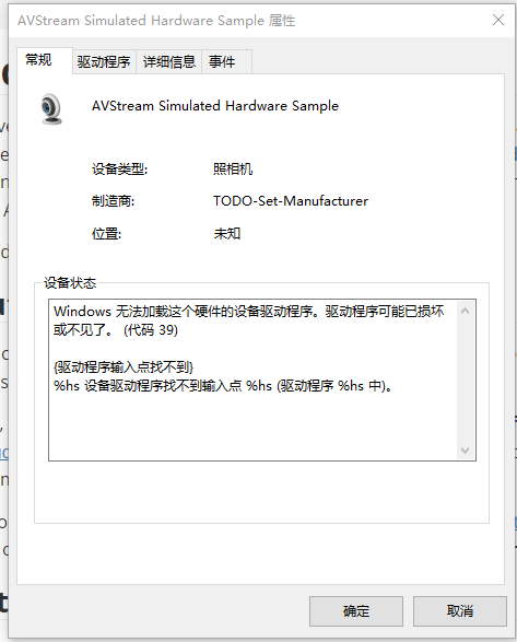

I successfully compiled the project file(Windows-driver-samples-main\avstream\avshws) using VS2022 and generated the avshws.sys,avshws.inf,avshws.cat. Install the driver according to the "README.md" on Win10 22h2. It is not going well,
"Windows is unable to load the device driver for this hardware. The driver may be damaged or missing. (Code 39)
{The driver input point cannot be found}
%hs The input point cannot be found in the %hs device driver (%hs within the driver)."

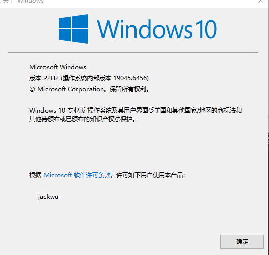

    • The WDK version used to build the driver
    • Your Windows version and build (winver)

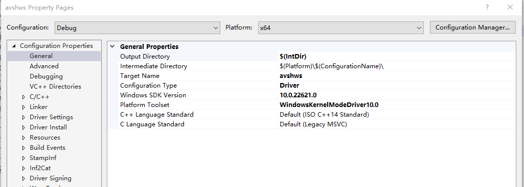

    • The target architecture (x64, x86)
    • Whether you built Debug or Release

    The Code 39 error indicates that Windows cannot load the avshws.sys driver because the driver binary is failing to load. For this sample, the typical cause is incorrect or outdated project/build settings that produce a driver binary that does not match the target OS or its dependencies.
    To fix the avshws.sys driver in this scenario:
    1. Update the avshws sample project settings to the current WDK/Visual Studio toolset so that it matches the Windows 10 22H2 environment.
    2. Rebuild the driver (avshws.sys, INF, CAT) with the corrected project configuration.
    3. Reinstall the driver so that Device Manager picks up the newly built binary.
    This aligns with the reported resolution where adjusting the project settings resolved the CM_PROB_DRIVER_FAILED_LOAD / Code 39 problem for avshws.
