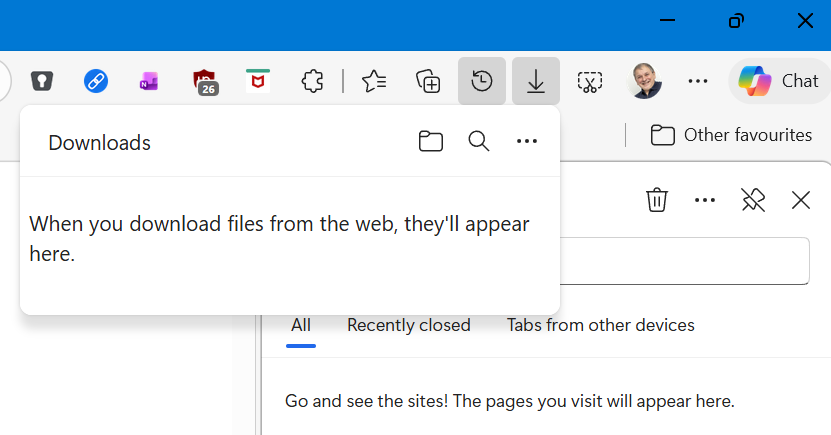

Two threads on a really annoying (and usability) issue with Edge losing the Pin to Right Hand Side button on the Downloads dialog
https://learn.microsoft.com/en-gb/answers/questions/5738922/edge-downloads-pin-button-is-missing - this was answered with some updates but then came back for some of us
https://learn.microsoft.com/en-us/answers/questions/5787155/edge-downloads-pin-button-is-missing-(still) - I though I had a fix but cloud sync has frankly recreated the problem again
It seems now, after many days of testing, diagnostics, and other work which eventually always comes back to the issue coming back --- that there is some bad "configuration" setting/information getting sent up to the cloud sync that replicates this problem across machines over time!
I would like to absolutely 100% delete the cloud sync data and make sure the new sync data comes from one, trusted installation - but I can't work out where sync'd data is coming from (Android and Windows) and having done all I could to ensure it was sync'd from one device, the problem reoccurs after around 18 hours, implying something is getting sync'd with the "bad" data!
  • Any way to physically delete the file using PowerShell?
  • Any way to get logs of where the updates in the cloud sync data have come from?
  • Any suggestions on how to fix an issue in Edge which manages to come back even after many steps to fix it? WITHOUT BINNING MY MICROSOFT ACCOUNT which is not feasible on many levels.
