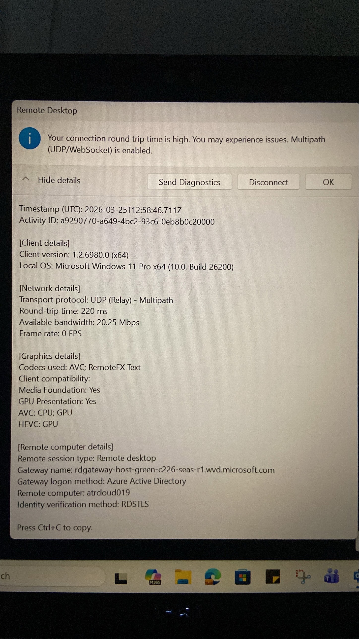

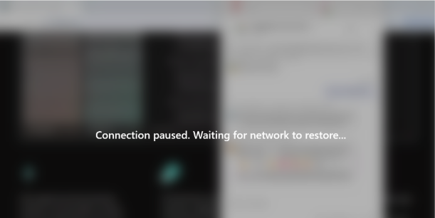

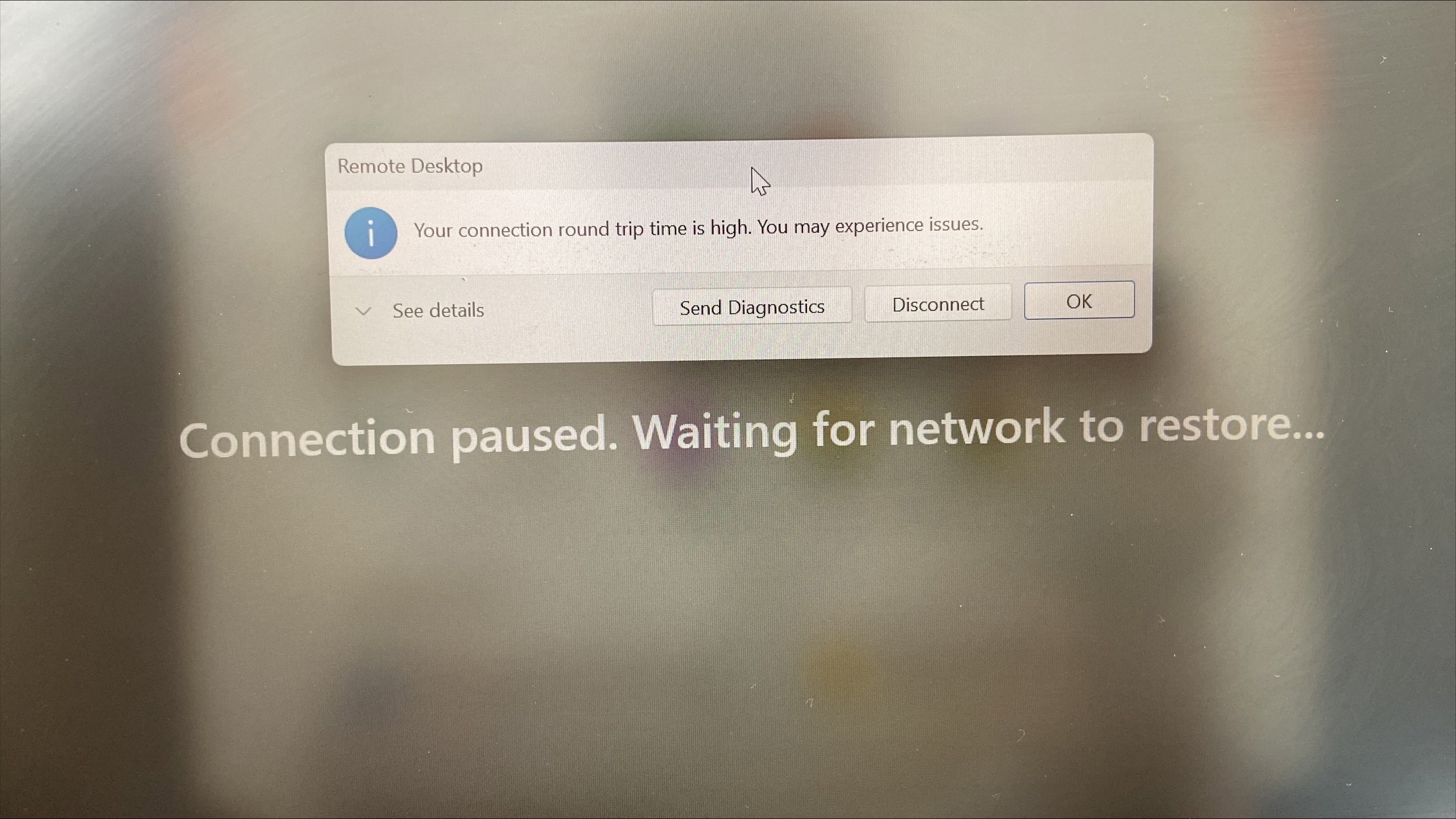

I have attached the screenshots of the error messages that we were getting.Screenshot 2026-03-25 100658

    Based on the logs you shared, the core issue is not the Cloud PC itself but network latency.
    From your screenshot, the round-trip time is around 220 ms. This is considered very high for a Windows 365 / Remote Desktop session, and it commonly causes freezing, disconnections, and severe lag. The fact that FPS drops to 0 and you see "Connection paused" strongly indicates a network path issue.
    Since you have already tried restarting the Cloud PC, reinstalling the app, and reassigning the license, this is very unlikely to be a client-side problem. The focus should now be on the network connection.
    The first thing to check is the Azure region of the Cloud PC. If the Cloud PC is hosted in a region far from the user’s location, latency can easily exceed 200 ms. In that case, reprovisioning the Cloud PC in a closer region is recommended.
    Second, if you are using a VPN or any security appliance, you should disable it and test again. The log shows UDP relay, which suggests the connection is not direct but going through a relay path, significantly increasing latency.
    Third, try connecting from a different network (for example, a mobile hotspot). If performance improves, then the issue is likely related to your current ISP or corporate network routing.
    In conclusion, this is most likely a network latency issue (220 ms) rather than a Cloud PC fault. You should prioritize checking the region, VPN usage, and network routing to resolve the problem.

    The screenshots show high round‑trip time and “Connection paused. Waiting for network to restore…”, which indicates a connectivity/latency problem between the user device and the Cloud PC session rather than a Windows 365 service outage or a local Windows 365 app issue.
    Because the Cloud PC becomes unusable for calls and meetings and the usual client‑side steps have already been tried (restart Cloud PC, reassign license, reinstall Windows app, test web client, check internet), the next step is to collect diagnostics and open a Microsoft support case so the backend connection path can be investigated.
    Use these steps to prepare for escalation:
    1. From the Remote Desktop/Windows 365 client notification, select Send Diagnostics when the “round trip time is high” message appears. This uploads connection telemetry that Microsoft support can use.
