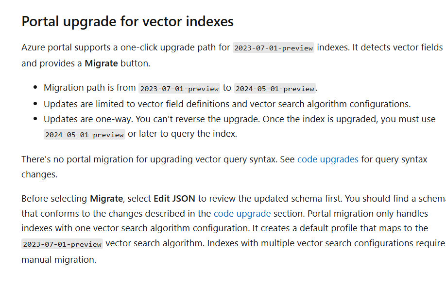

This is expected behavior and not a portal issue Based on Microsoft documentation, the Azure portal offers a one-click “Migrate” option only for vector indexes created with the 2023‑07‑01‑preview API. If this option appears, it allows you to update the vector schema to a newer API version. If you don’t see it, the index likely doesn’t qualify for portal-based migration.
This usually happens if:
- The index wasn’t created with the 2023‑07‑01‑preview API,
- The index already uses a newer stable or preview API version, or
- The index has multiple vector algorithm configurations, which aren’t supported for portal migration and need manual changes.
If portal migration isn’t available, you should manually update the index using the Azure AI Search REST APIs or recreate the index with a supported API version.

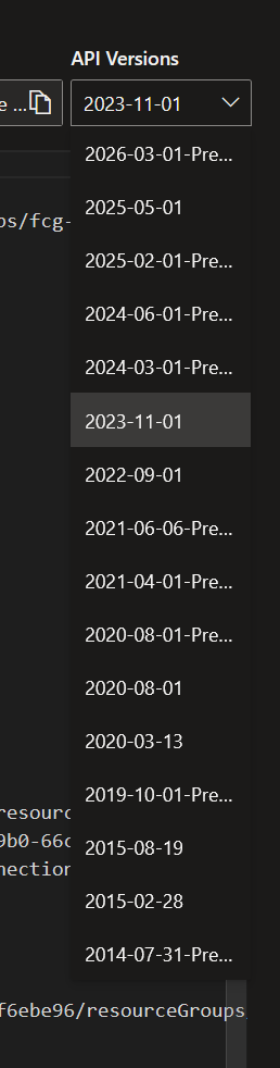

2026-03-30T15:13:07.0766667+00:00 The API version for our Search Service is 2023-11-01.
Do we have to downgrade to 2023-07-1 in order to upgrade to 2023-07-1 preview (which doesn't seen to be one of the possible API versions, see attached)?

2026-03-30T16:37:12.61+00:00 Hi @Lloyd Newby
Thank you for the update and for sharing the screenshot of the available API versions that’s very helpful.
To directly address your questions:
- No, you do not need to downgrade to 2023-07-01-preview. In fact, you cannot downgrade API versions in Azure AI Search. The 2023-07-01-preview version is now deprecated, and your current service is already on the newer, stable 2023-11-01 version, which is the correct and recommended path.
- The “Migrate” button in the Azure portal only appears for indexes that were originally created using the 2023-07-01-preview API version. Since your index was created (or last updated) with 2023-11-01, the portal migration option is not available. This is expected behavior, not an issue with your service.
