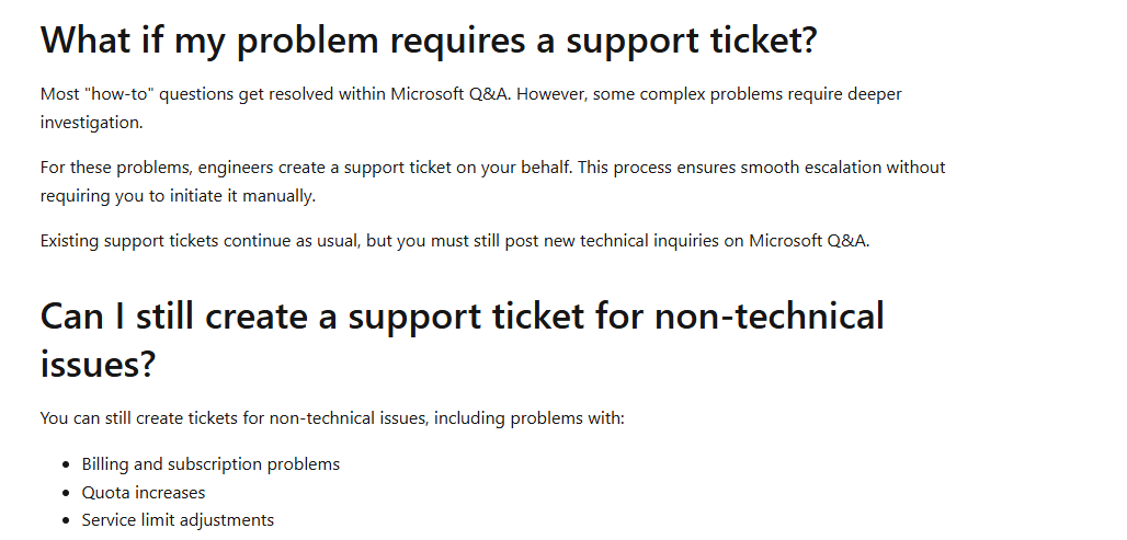

  3. Marcin Landowski 0 Reputation points
    2026-03-26T15:46:52.3166667+00:00
    Could I have a ticket submitted and a technician assist? User's image
