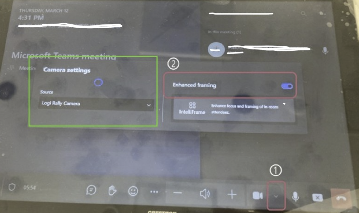

The issue is visible on the touch panel display during the Teams call. The selectable manual button for the logical camera  is not visible, but instead with a Teams loading ring state above the device name field. (Logi Rally Camera)
