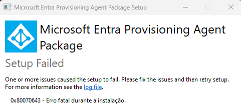

User's image I'm trying to install the Microsoft Entra Provisioning Agent (AADConnectProvisioningAgentSetup.exe) on a Windows 10 x64 machine.
The installation always fails with Error 0x80070643 when executing the MSI Microsoft.SCIM.Provisioning.Setup.msi.
Environment
  • OS: Windows 10 x64 (Build 22631)
  • Installer version: 5.0.2.0
  • .NET Framework: Installed (condition NETFRAMEWORK45 >= 461808 evaluates to true)
  • Installation executed as local administrator
  • Windows Update enabled
Expected behavior
The provisioning agent should install successfully.
Actual behavior
The MSI installation fails with error 0x80070643 and rolls back.
Relevant log excerpt (sanitized)
i301: Applying execute package: Microsoft.SCIM.Provisioning.Setup.msi e000: Error 0x80070643: Failed to install MSI package. e000: Error 0x80070643: Failed to execute MSI package. e000: Error 0x80070643: Failed to configure per-machine MSI package.
The full installer runs without UI (WixStdBASuppressOptionsUI=1). No additional error is shown on screen.
Has anyone encountered this issue with the Entra Provisioning Agent? Are there known prerequisites, permissions, or Windows components that could cause this MSI error during installation?
Any guidance would be appreciated. ``
