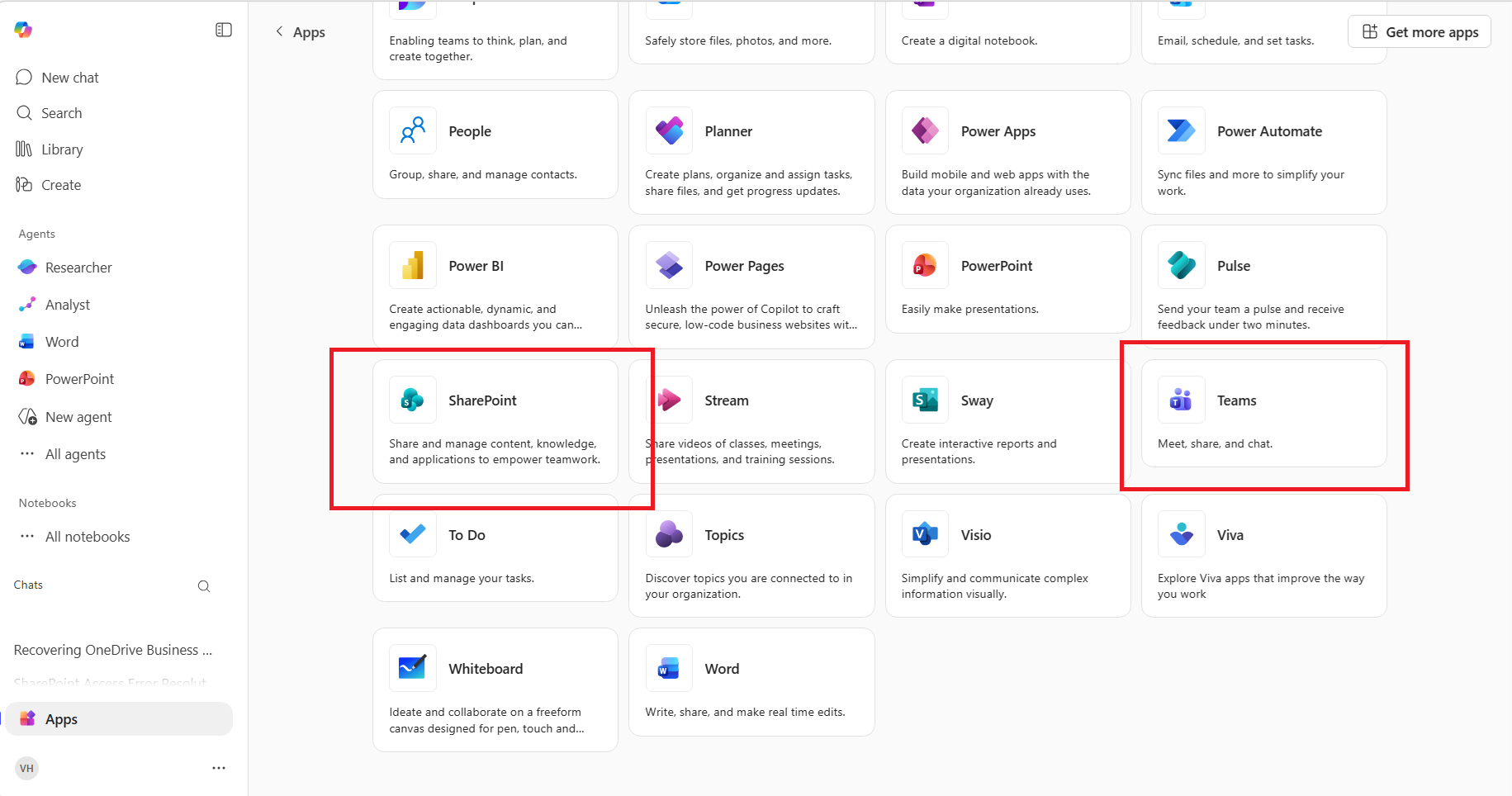

Hi, I bought a new computer, and I elected to have MS Business Standard installed on it. I have access to all apps, except SharePoint and Teams. I viewed the product licenses in the admin portal, and it shows SharePoint under licensing, but when I've selected All Apps, SharePoint and Teams are nowhere to be found. I've contacted Microsoft Support and they were no help (see why below). A couple things I suspect to be the problem.
  • The MS Office App is still in a trial - all of the other apps work fine, but maybe Sharepoint doesn't work in a trial?

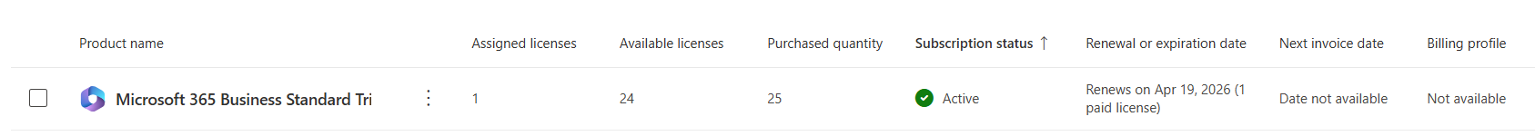

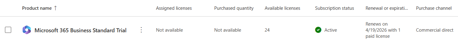

  • Under users there is a wall of text with an error message"The execution of XXXXX Remove-DelayedDelicensingeXXXXXX failed." Under products, I see the sharepoint license, but I cannot click it or select it. I suspect there is a license issue, because when I first went to my business admin portal, it was called TBDXXX. I suspect it was set up this way when installed. The rep told me to unassign/reassign the license, but when I asked how, he said remove/add the license. Not much help. I looked up direction and since I am the only license, I am afraid doing this will effectively end my subscription.

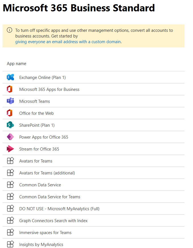

    1/ The exact license name assigned to your user (for example, Microsoft 365 Business Standard vs. a version labeled “(No Teams)”)
    2/ Whether your subscription was purchased directly from Microsoft or through a partner/reseller

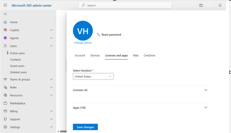

    3/ Whether you see Teams listed as enabled under Licenses and apps for your user account in the Microsoft 365 admin center. If possible, I recommend you try to unassign and reassign license. For detailed instructions, please follow: Use the Active users page to unassign licenses
    Some Microsoft 365 SKUs explicitly exclude Teams, and partner‑managed subscriptions can also affect how Teams is provisioned, so this information is required to troubleshoot Teams access correctly.
