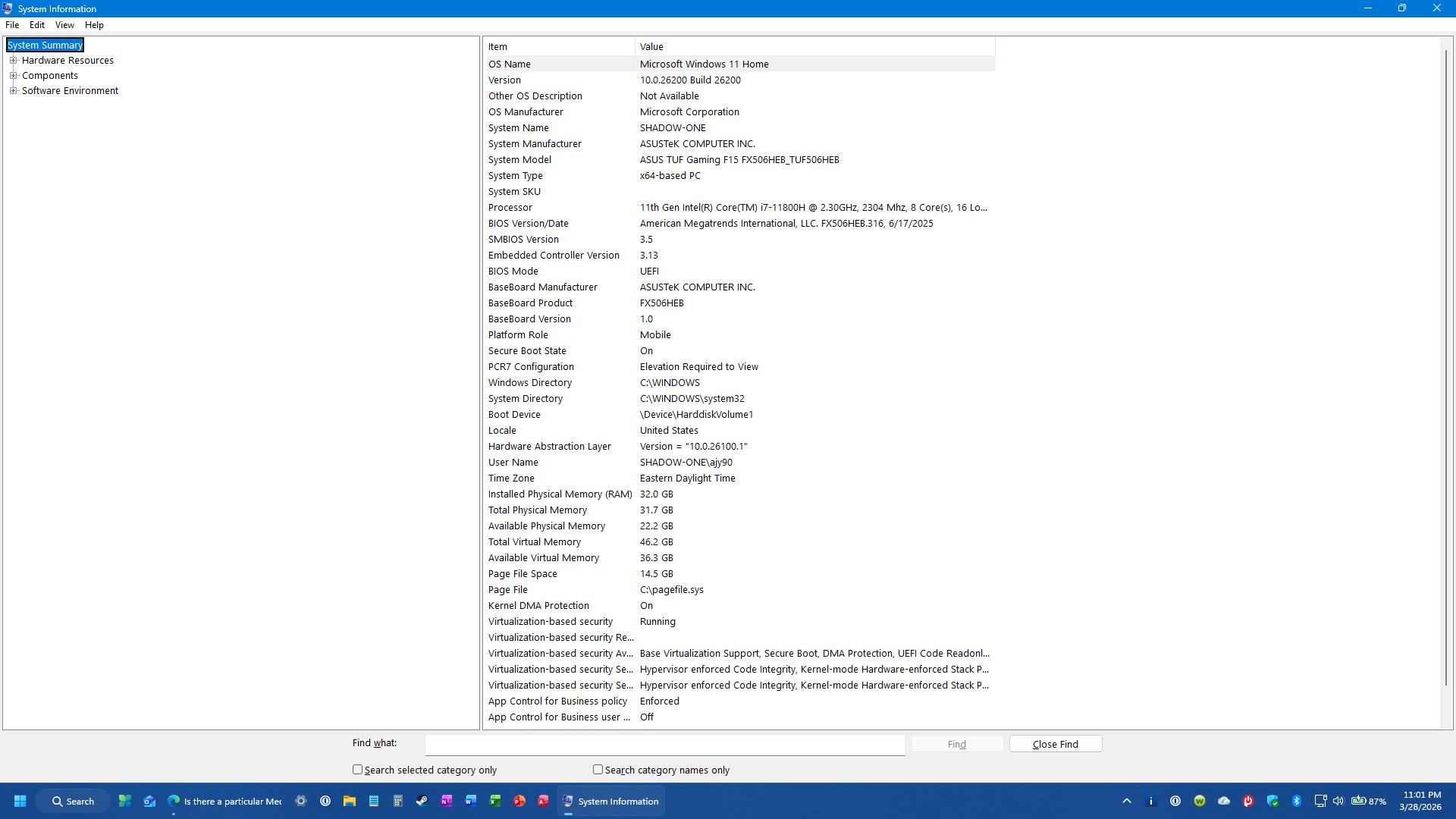

  1. Ivan B 107.3K Reputation points Independent Advisor
    2026-03-28T21:29:00.08+00:00
    In this case, the driver might be an incorrect version and causing error code 31. Remember that a hardware failure is also possible.
    Laptop drivers can be modified by the manufacturer, requiring the use of versions provided by the laptop manufacturer instead of the chip manufacturer.
    To check, access msinfo32.exe in the search bar, take a screenshot, and post it here.
    Thanks
