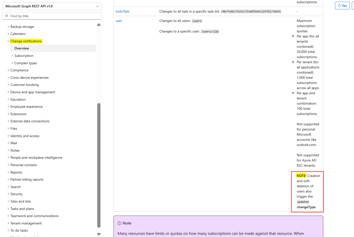

  1. Sridevi Machavarapu 27,315 Reputation points Microsoft External Staff Moderator
    2026-03-31T11:56:10.7966667+00:00
    Hello 43091962,
    Your setup looks correct. This behavior is expected for /users.
    From the documentation:
    Creation and soft deletion of users also trigger the updated changeType. Reference: https://learn.microsoft.com/en-us/graph/change-notifications-overview#supported-resources
    When a user is created, the system usually performs a few additional updates right after. Because of that, Graph often sends only an updated notification, and created may not come separately.
    So "changeType": "created" may not trigger, while "changeType": "created,updated" works.
    This is expected behavior. Creation can show up as an updated event, so it’s recommended to include updated when subscribing to /users. There’s no real difference between creating users via Graph API or the Portal in this case.
    You can continue with:
    Then fetch the user (GET /users/{id}) and use createdDateTime to identify newly created users.
