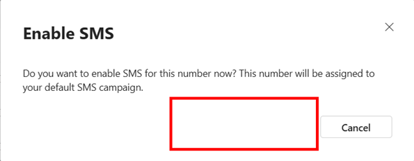

2 weeks ago, I went to enable SMS for another phone number and the only option I am given is to Cancel:

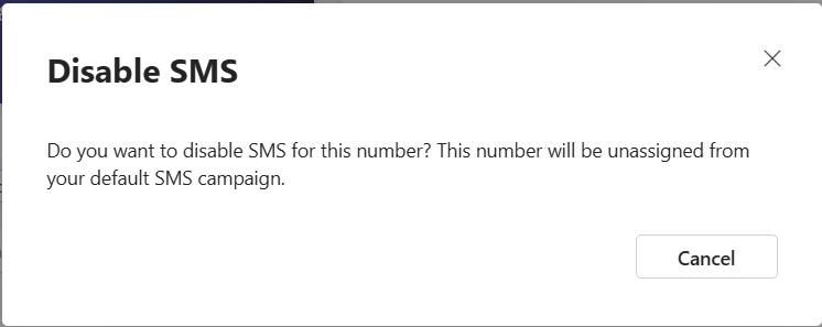

I also get a similar pop up if I try to disable SMS for a phone number that currently has SMS enabled:

    Thank you for providing the detailed screenshots and outlining the troubleshooting steps you’ve already taken.
    From your description, I understand that although your SMS Brand and Campaign were approved in 2025 and 17 numbers are functioning correctly, you are currently unable to enable SMS for any additional phone numbers. Despite your Know Your Customer (KYC) being approved on March 25th, the Teams Admin Center (TAC) only presents a "Cancel" button when attempting activation, and PowerShell commands (Set-CsPhoneNumberSmsActivation) are not triggering the process.

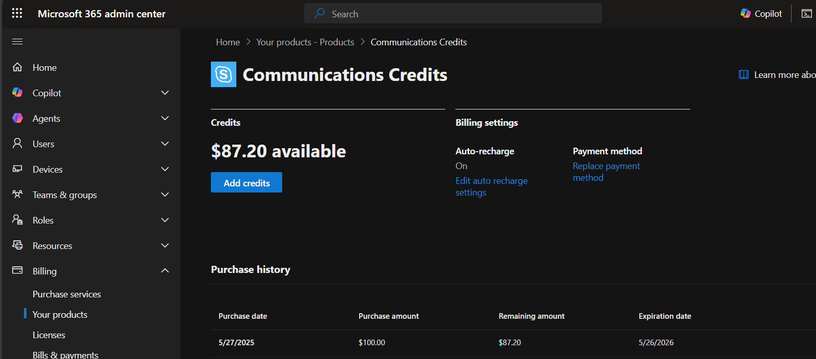

    Billing / Communication Credits:
    A common cause is that billing is either not configured or not fully recognized by the system. Even when a campaign is approved, enabling SMS for additional numbers may require active Communication Credits or a valid billing profile. If this is not in place (or not properly linked, especially in CSP scenarios), the system may block new activations.

    1/ Verify Billing Configuration (Communication Credits / Payment Method): Please confirm that your tenant has an active billing setup:
    Sign in to Microsoft 365 Admin Center as Global Admin account
    Navigate to Billing > Your products or Payment methods
    Check:
    • Whether a valid payment method (credit card/invoice) is added
    • Whether Communication Credits are enabled and funded
