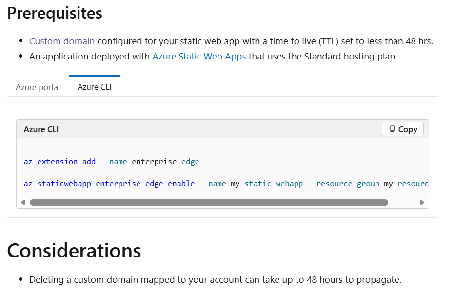

      Enterprise-grade edge requires:
      • A Static Web App on the Standard plan (not Free).
      • A custom domain configured with TTL < 48 hours.

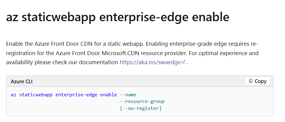

    2. Microsoft.CDN resource provider not registered
      Enabling enterprise-grade edge uses Azure Front Door and requires the Microsoft.CDN resource provider to be registered in the subscription. If it is not, the operation can fail and revert. Use Azure CLI to both register and enable, which surfaces errors more clearly:
         # 1. Ensure the extension is installed
         az extension add --name enterprise-edge
         # 2. (Recommended) Let the command auto-register Microsoft.CDN
         az staticwebapp enterprise-edge enable \
           --name <your-static-webapp-name> \
           --resource-group <your-resource-group>
      If auto-registration is disabled or fails, register manually:
         az provider register --wait --namespace Microsoft.CDN
      If this command fails, the CLI output will show the exact error (for example, missing provider registration or permission issues).
