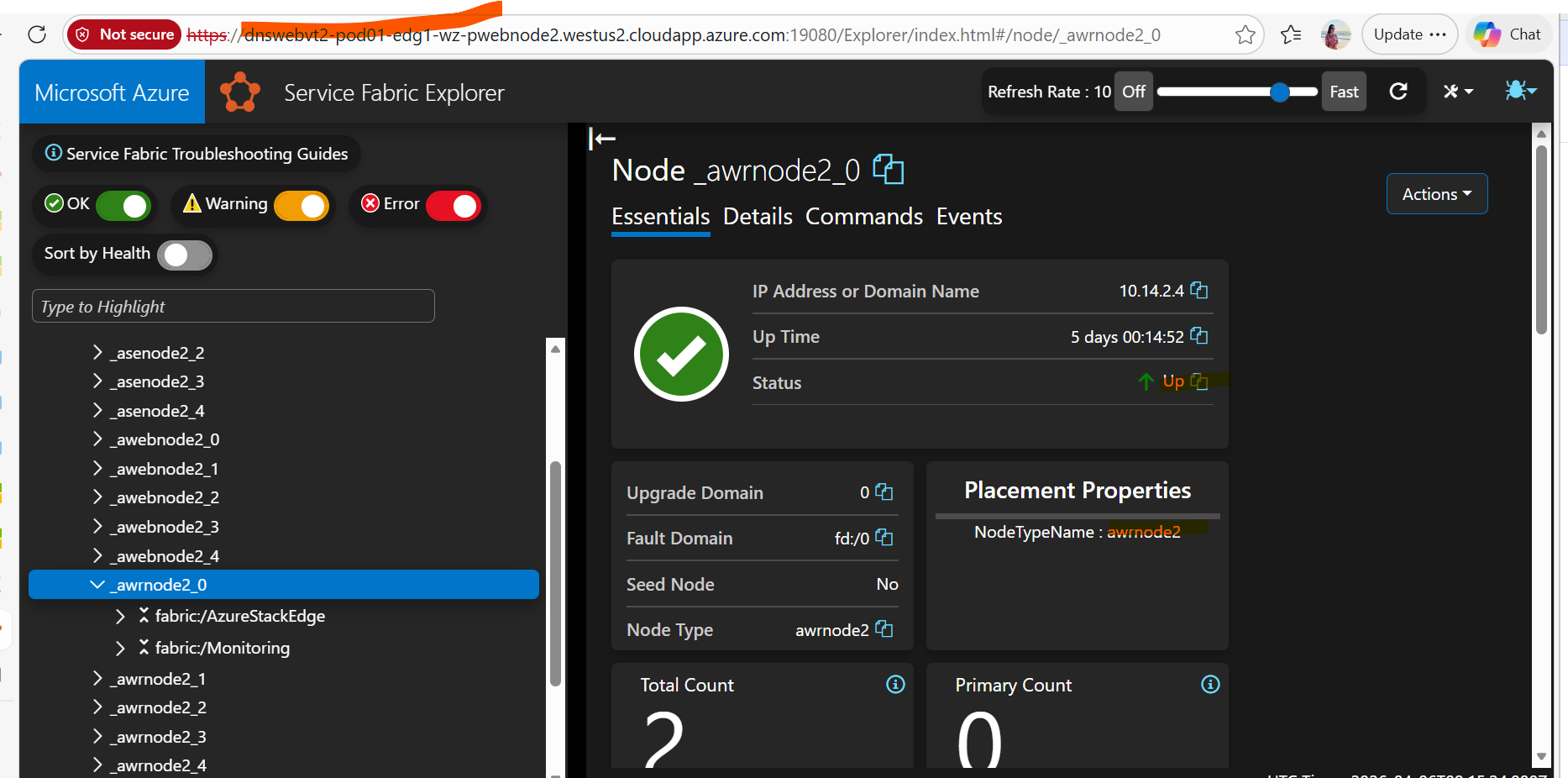

We tried deploying cluster and vmss in location other than resource group location which is west europe and tried deploying vmss &cluster in westus2. Resource deployment got successful but applictaion deployment is failing in cluster .We need help to understand th eissue .

    Your cluster and VM Scale Sets deployed successfully in the new location (westus2), but the fabric:/AzureStackEdge application is in an Error health state. The Cluster Resource Manager cannot place secondary replicas for partition [GUID REMOVED] because no nodes satisfy the placement constraint NodeType==awrnode2. Many nodes were eliminated (15 by placement constraints and 5 by ServiceTypeDisabled/NodesBlockListed), leaving zero suitable nodes for the required replica set size.
    This is a common Service Fabric placement-constraint mismatch that occurs when an application’s service manifest expects a specific node type that is either missing, not scaled out, or unhealthy in the target cluster.
    Recommended solution Check and align your cluster’s node types with the requirements of the AzureStackEdge application:
    1. Open Service Fabric Explorer → Nodes and verify:
      • Are any nodes listed with NodeType = awrnode2.
      • Are those nodes in Up and OK health state?
    2. If the awrnode2 node type is missing or has zero healthy nodes:
      • Update your cluster ARM template (or Bicep) to include a VM Scale Set with nodeTypeRef: "awrnode2".
      • Redeploy or scale the cluster to add the missing node type.
    3. Review the full constraint elimination sequence in the partition’s details for any additional block-listing or disabled service types.

  1. kagiyama yutaka 2,425 Reputation points
    2026-04-05T08:07:29.66+00:00
    I think the naming primary just never settles after the cross‑region build… if SFX shows no steady primary, rebuild everything in one region; if that still fails, recreate the RG to clear the metadata.
