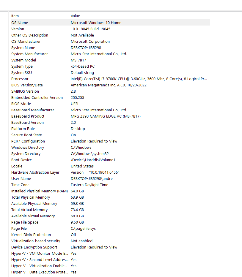

  2. Ivan B 105.6K Reputation points Independent Advisor
    2026-04-02T17:59:31.8966667+00:00
    If you're trying to install Windows 11 using the update process ?
    Access Msinfo32.exe in the search bar, take a screenshot and post it here.
