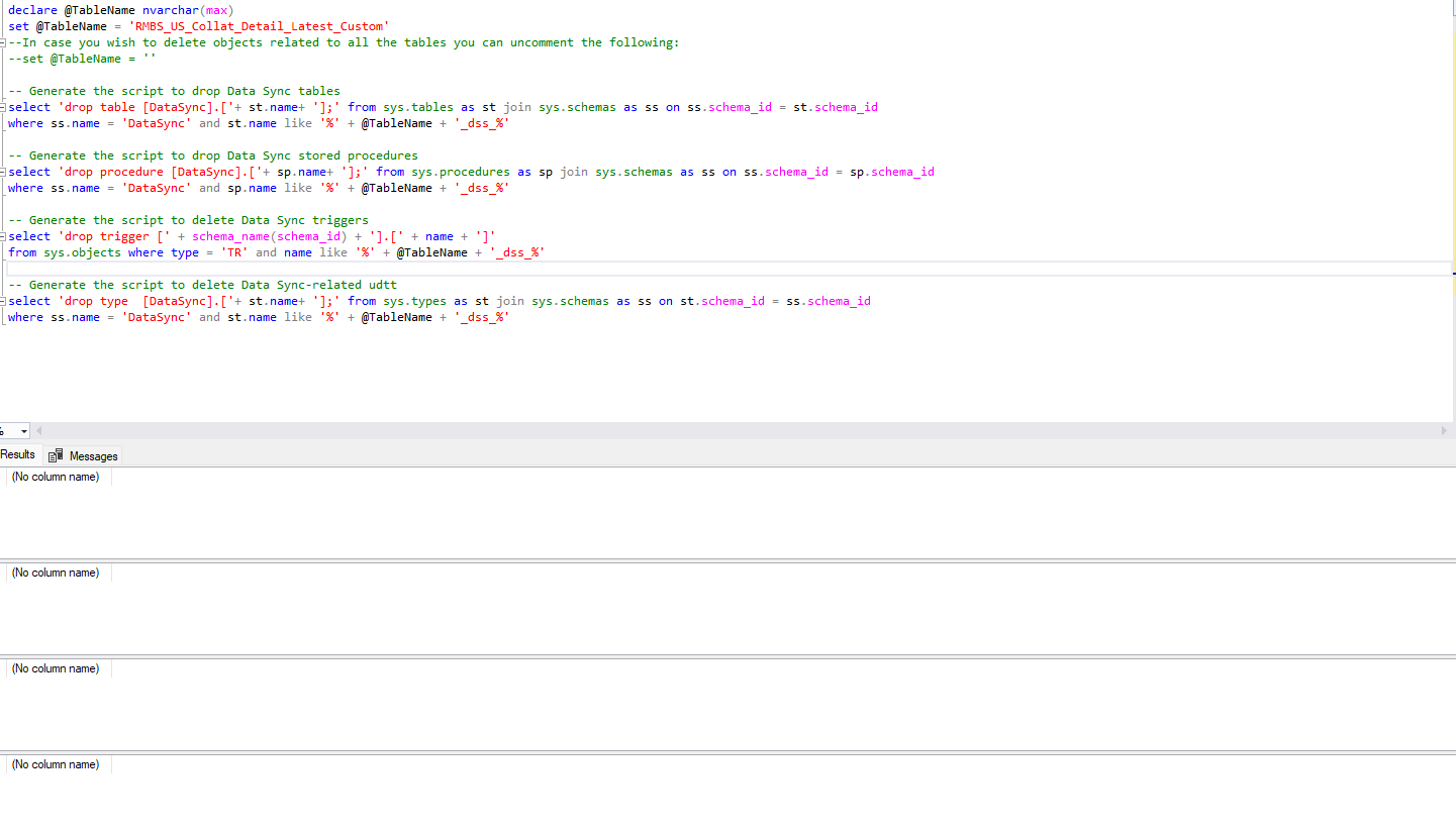

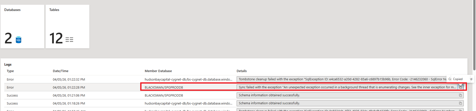

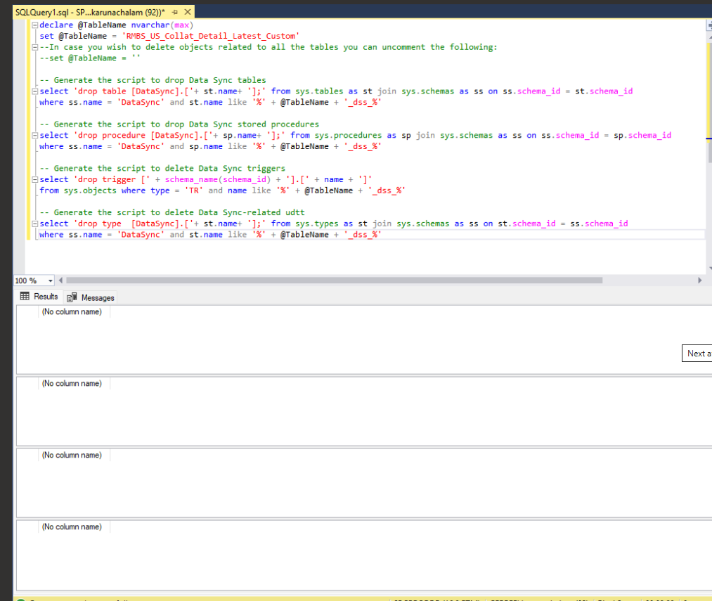

We are facing issue in Azure Data Sync in one of our data sync groups. The sync group had 13 tables that were syncing from the Hub (Azure SQL DB) to the member DB(SQL On-Prem DB) on the client side. We removed a table "RMBS_US_Collat_Detail_Latest_Custom" from the sync group, ran the attached script and removed any residual sync objects for that table. The same script was run by the client and the sync objects and the table itself was dropped so that we could do the schema changes and readd the table back to the sync group. When readding the table , after the schema changes, we are getting the following error on the sync group, even though the table is not added back now. We are just syncing the group to make sure the remaining tables sync successfully, before adding the removed table back again. The Hub and Member DB schema has been refreshed in the syncgroup, made sure there are no sync objects left for the removed table using the script provided by Microsoft support earlier. Still, we keep getting the same error. The sync group itself is not working now. Obviously, we can't remove all the client tables in the sync group again as it will impact their production environment. Please let us know how to fix the issue and proceed further.
Error: Sync failed with the exception "An unexpected exception occurred in a background thread that is enumerating changes. See the inner exception for more details.Inner exception: The stored procedure '[DataSync].[RMBS_US_Collat_Detail_Latest_Custom_dss_selectchanges_ee76f35b-6163-403e-9314-9ee72be12371]' doesn't exist. For more information, provide tracing ID ‘d86906ab-d606-4704-a467-bd22c60879aa’ to customer support."

    From the symptoms you described, the sync group kept trying to enumerate changes for the removed table because Data Sync metadata still contained a reference to that table, even after the table was removed from the sync schema and the table-level DataSync objects were dropped. That is consistent with the behavior you observed: once you refreshed the schema and manually removed stale references in DataSync.scope_config_dss (the config_text field), the sync group was able to start again.
    In other words, this wasn’t caused by the remaining 12 tables themselves—rather, it was a metadata inconsistency / leftover reference that caused Data Sync to look for a procedure that had already been removed: [DataSync].[RMBS_US_Collat_Detail_Latest_Custom_dss_selectchanges_ee76f35b-6163-403e-9314-9ee72be12371].
