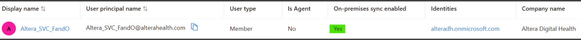

while creating user in microsoft dynamics 365 getting an error The user with this email does not exist in Microsoft Entra ID.
Gopal Patil 0 Reputation points
2026-04-06T09:32:11.44+00:00
User is correct, UPN is matching, it is also in sync.

    Thanks for confirming that the mail attribute is unique and matches the UPN.
    Since this is verified, please check the following additional points that commonly cause this Dynamics 365 validation error:
