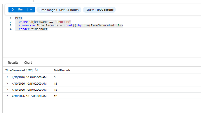

    2.Performance Counter for Process Count:
    For near real-time monitoring of process count metrics, you can configure custom performance counters using a Data Collection Rule (DCR) with the Azure Monitor Agent.
    • Works for both Windows and Linux VMs
    • Useful for alerting scenarios (for example, when process count exceeds a threshold)
    • Best suited for numeric monitoring rather than detailed process inspection
    Reference: https://learn.microsoft.com/en-us/azure/azure-monitor/vm/data-collection-performance

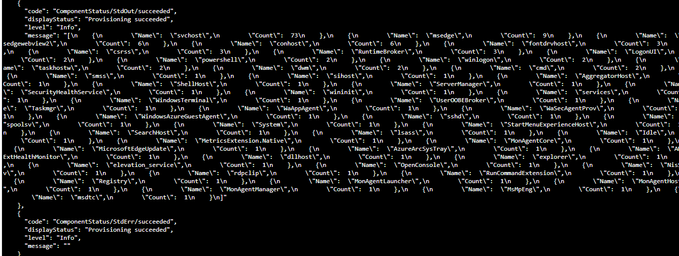

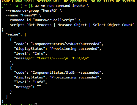

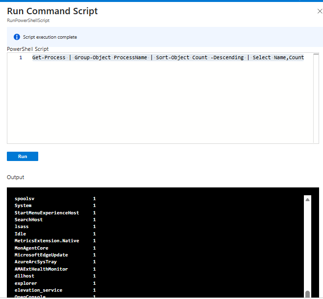

    1. Azure VM Run Command (On-Demand / Ad-hoc)
    For one-time or ad-hoc retrieval without relying on continuous monitoring:
    Windows:
    az vm run-command invoke --resource-group <ResourceGroupName> --name <VMName> --command-id RunPowerShellScript --scripts "(Get-Process).Count"
    Note: This approach is recommended for on-demand checks only and is not suitable for continuous monitoring or alerting scenarios.
