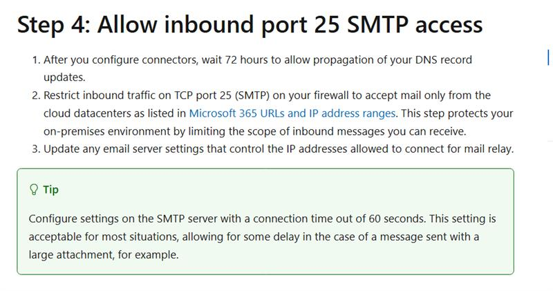

    You should not modify the Default Frontend Receive Connector (leave Remote IP Ranges as “All” and Anonymous authentication enabled). The Hybrid Configuration Wizard (HCW) already configures the necessary TLS settings on this connector for secure hybrid mail flow.
    Secure at the firewall level: Block inbound TCP port 25 from the public internet.
    Allow inbound TCP port 25 only from the official Exchange Online Protection IP ranges (published in the Microsoft 365 URLs and IP address ranges document).
