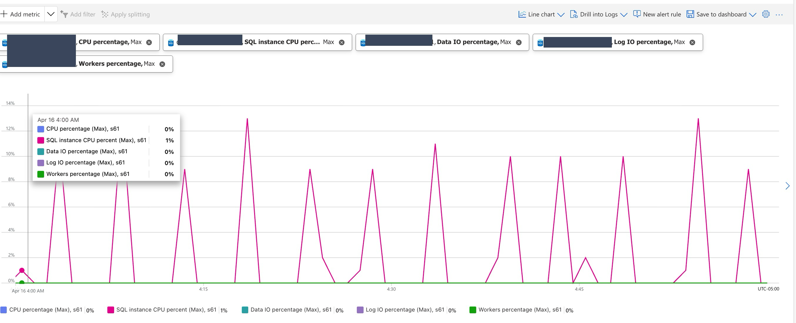

On Dev 1, I am seeing recurring CPU spikes on the SQL instance CPU percent metric every 5 minutes exactly between 3:00 AM and 5:00 AM CDT (08:00 to 10:00 UTC). Dev 2 shows no such pattern during the same window, despite receiving the same application traffic and queries. Because both environments receive identical traffic from the same types of systems, the difference in behavior is not attributable to Dev 2 having less activity or fewer connections. The only meaningful configuration difference is the auto-pause setting.
Observed behavior (Dev 1: auto-pause enabled)
The Azure Monitor metrics chart below shows the 5-minute interval spikes on SQL instance CPU percent reaching 8-13% between 4:00 AM and 4:50 AM CDT (09:00 to 09:50 UTC) on 2026-04-16, while CPU percentage, Data IO, Log IO, and Workers all remain flat at 0%.
Investigation summary
To identify the cause I queried AzureMetrics in Log Analytics scoped to the spike window. This confirmed 12 consecutive spikes at exactly 5-minute intervals with SQL instance CPU reaching 9-13%, matching the chart. The same query against Dev 2 returned nothing above 2%.
I then checked AzureDiagnostics for SQLSecurityAuditEvents and Connections during the same window. No results were returned, confirming no user or application connections were made to Dev 1 during the entire 3:00 AM to 5:00 AM CDT window.
Querying sys.query_store_runtime_stats on Dev 1 for the same window returned only two internal queries: a SELECT against an internal backup_metadata_store table (query_id 177931) and a poll of sys.dm_db_resource_stats (query_id 112304). Both had object_id = 0, confirming they are Azure platform queries and not user-defined code or scheduled jobs. The same Query Store query against Dev 2 returned no results.
Finally, querying AzureDiagnostics for QueryStoreRuntimeStatistics during the spike window confirmed that query_id 177931 and query_id 112304 were the only queries active at every spike interval, with no other activity present.

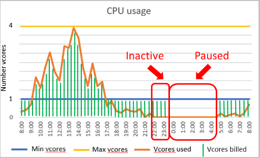

    **Azure serverless database bills for the amount of compute used per second. The serverless compute tier also automatically pauses databases during inactive periods when only storage is billed and automatically resumes databases when activity returns.
    The configuration of these parameters shapes the database performance experience and compute cost.
    Diagram indicating when serverless billing would stop incurring compute charges due to inactivity.
    The auto-pause delay is a configurable parameter that defines the period of time the database must be inactive before it is automatically paused. The database is automatically resumed when the next login or other activity occurs. Alternatively, automatic pausing can be disabled.
    The cost for a serverless database is the summation of the compute cost and storage cost. The storage cost is determined in the same way as in the provisioned compute tier.
    • When compute usage is between the minimum and maximum limits configured, the compute cost is based on vCore and memory used.
    • When compute usage is below the minimum limits configured, the compute cost is based on the minimum vCores and minimum memory configured.
    • When the database is paused, the compute cost is zero and only storage costs are incurred.
    Auto-pausing is triggered if all of the following conditions are true during the auto-pause delay:

  2. Manoj Kumar Boyini 14,500 Reputation points Microsoft External Staff Moderator
    2026-04-17T23:56:20.53+00:00
    Hi Daniel-4204,
    In the serverless tier, the database automatically pauses when idle and resumes when any activity occurs. This activity is not limited to user connections; it also includes internal platform operations such as automated backups, backup chain maintenance, and service-level monitoring. Microsoft documentation confirms that these operations are fully managed by the service and their timing is determined by the platform, not user-configurable:
    https://learn.microsoft.com/en-us/azure/azure-sql/database/automated-backups-overview
    The queries you identified (for example against internal metadata and DMVs, with object_id = 0) indicate Azure-initiated internal activity, not application workload. The reason you only see CPU spikes in Dev 1 is because auto-pause is enabled there. When the database is paused, any internal operation causes a resume event, which briefly brings the database online and results in visible CPU usage. In Dev 2, the database is always online, so the same internal work happens but does not appear as periodic spikes.
    Regarding billing, Azure SQL serverless compute is charged per second while the database is online, and not charged while paused. This means that even if the resume is triggered by internal platform activity, the time during which the database is active is still considered billable compute time:
    https://learn.microsoft.com/en-us/azure/azure-sql/database/serverless-tier-overview?view=azuresql&tabs=general-purpose
    Adjusting the auto-pause delay or disabling auto-pause are the only ways to reduce frequent resume cycles, but the internal maintenance behavior itself cannot be controlled. However, the behavior you are observing is consistent with internal service operations periodically waking a paused database.
    If you would like, we can further correlate these timestamps for deeper validation of this pattern in your environment.
