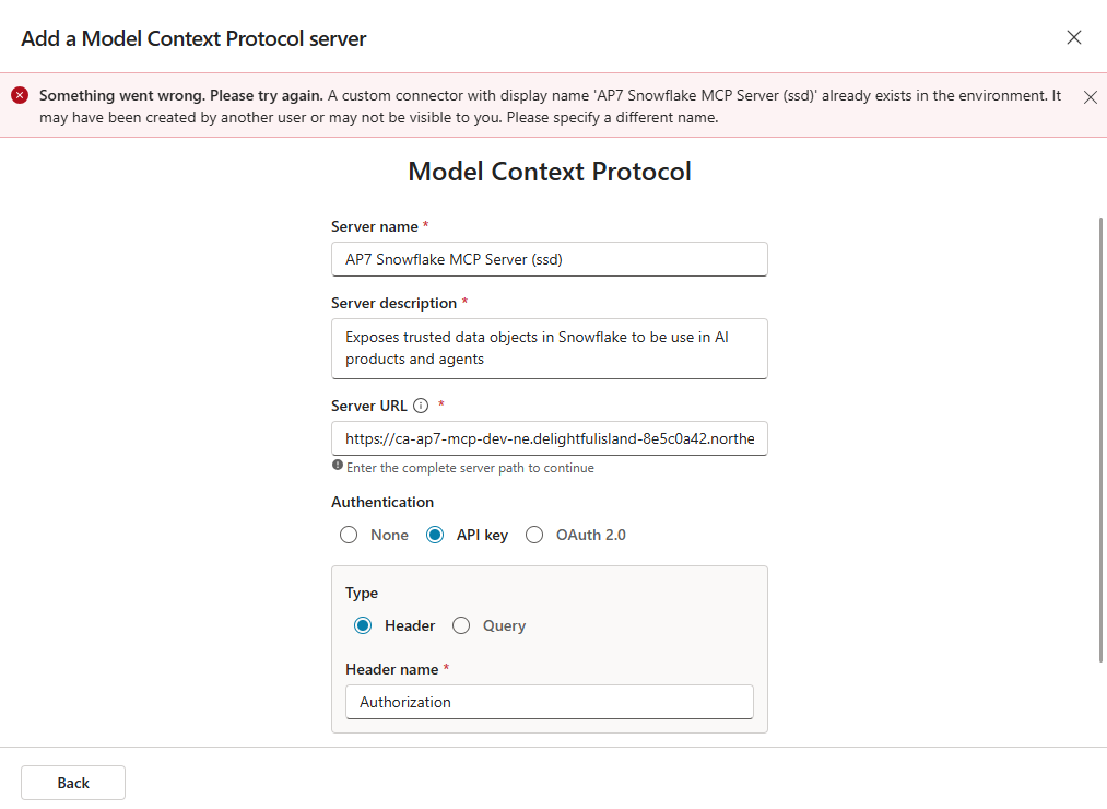

I have created a custom MCP Server in Azure (python container app) and want to add it as a tool for my agent. Under "tools" tab in Copilot Studio I chose to add a new Model Context Protocol Server, and always get (last three days or so) even with very different names:
"Something went wrong. Please try again.A custom connector with display name 'MCP Server for Snowflake' already exists in the environment. It may have been created by another user or may not be visible to you. Please specify a different name."

  4. Sayali-MSFT 5,766 Reputation points Microsoft External Staff Moderator
    2026-04-17T12:51:49.27+00:00
    Hello Stefan Solender ,
    When adding a custom MCP Server in Copilot Studio, the platform automatically creates a Power Platform Custom Connector in the background using the Server Name provided. If MCP onboarding fails at any stage—such as schema validation timeout, authentication challenge on the schema endpoint, or improper MCP metadata response—the connector may still get partially created in Dataverse but won’t appear in the Copilot Studio UI. This results in subsequent attempts to add the MCP failing with the misleading error stating that a connector with the same display name already exists in the environment, even when different names are used. The root cause is typically these hidden or orphaned custom connectors created during failed MCP onboarding.
    To resolve this, navigate to the same environment in Power Apps (make.powerapps.com), manually delete any related connectors under Custom Connectors, wait a few minutes for metadata sync, and retry MCP creation using a unique name. Additionally, ensure that your MCP container exposes a publicly accessible /.well-known/mcp/schema endpoint that returns a valid JSON response with HTTP 200 and does not require authentication, as Copilot Studio performs a schema probe during MCP registration.
