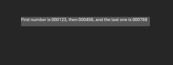

    Here's the result with the macro text above:
    Before:
    After
