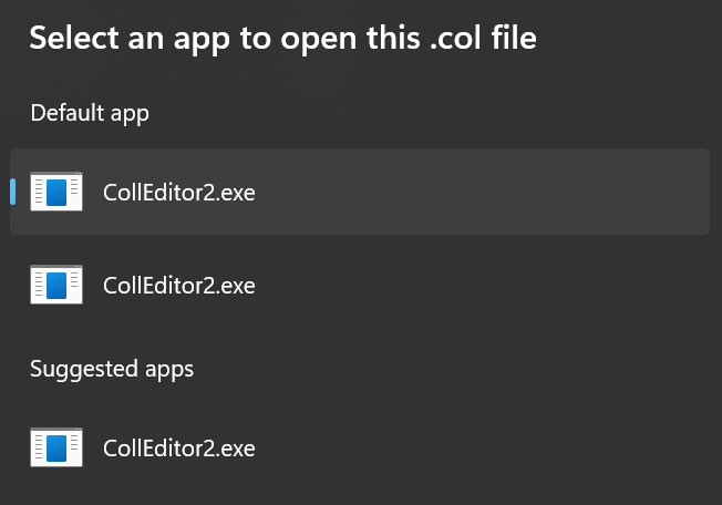

    I am having the exact same issue, the difference being I am experiencing this system-wide...Error
    Yes, for some reason I have duplicated no icon default app suggestions.
    Screenshot 2026-05-20 193744
    Idk if its the recent update or what but its is very annoying to work with & reinstalling windows changed nothing. Any other solution?
