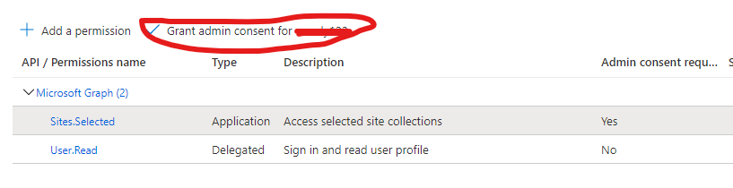

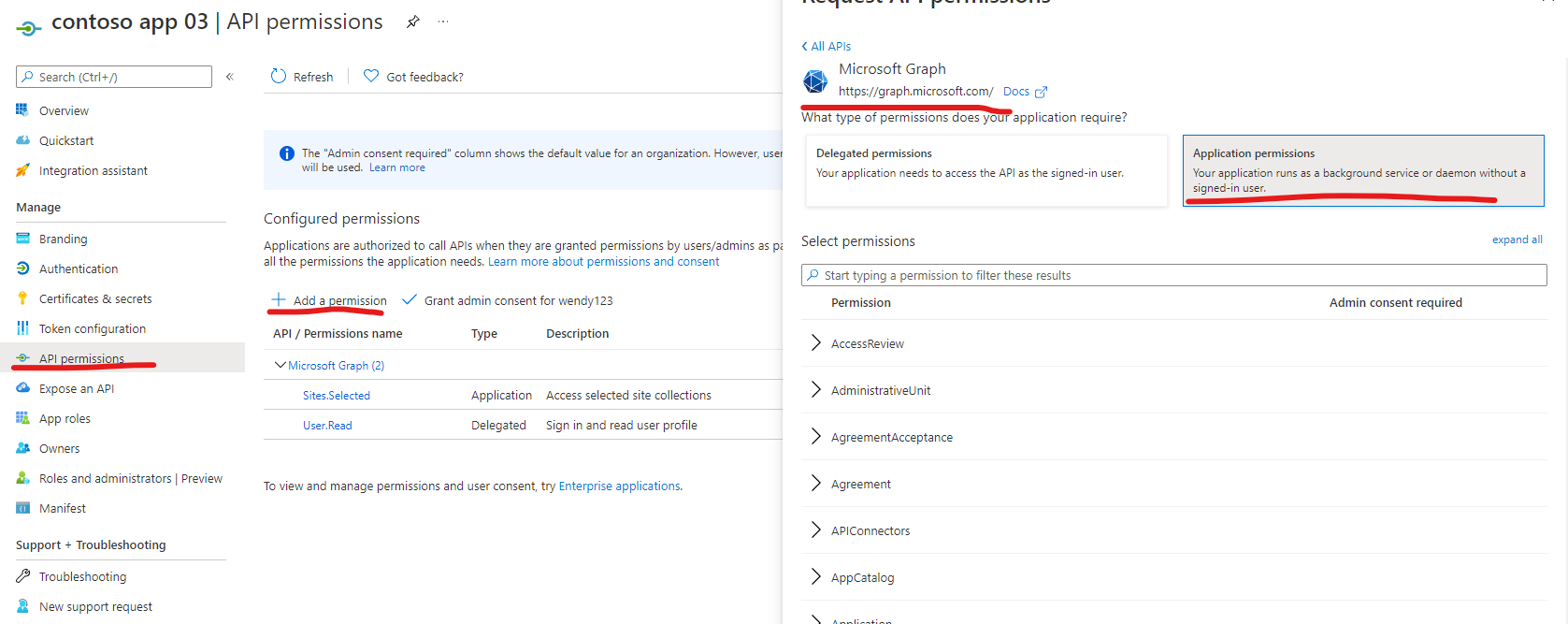

    1 Add the permission of Sites.Selected and grant admin consent

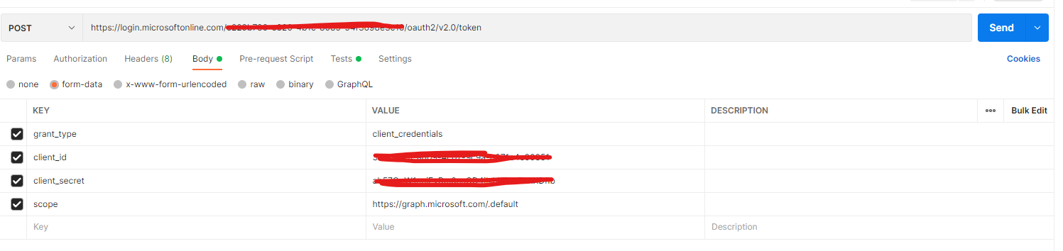

    3 Get access Token
    The url and body should be like following
    https://login.microsoftonline.com/{{directoryId}}/oauth2/v2.0/token
    KEY	                VALUE
    grant_type	        client_credentials
    client_id	        {{azureApp_clientId}}
    client_secret	{{azureApp_clientSecret}}
    scope	                https://graph.microsoft.com/.default

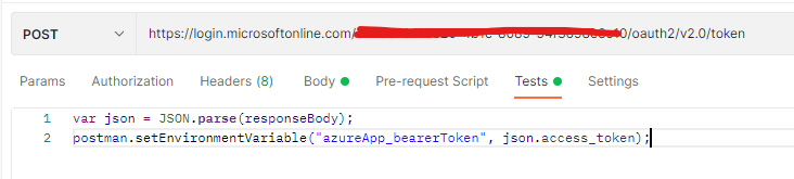

    and copy following code to Tests and click send
    var json = JSON.parse(responseBody);
    postman.setEnvironmentVariable("azureApp_bearerToken", json.access_token);

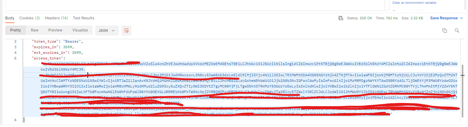

    We will get long string of access_token like following picture

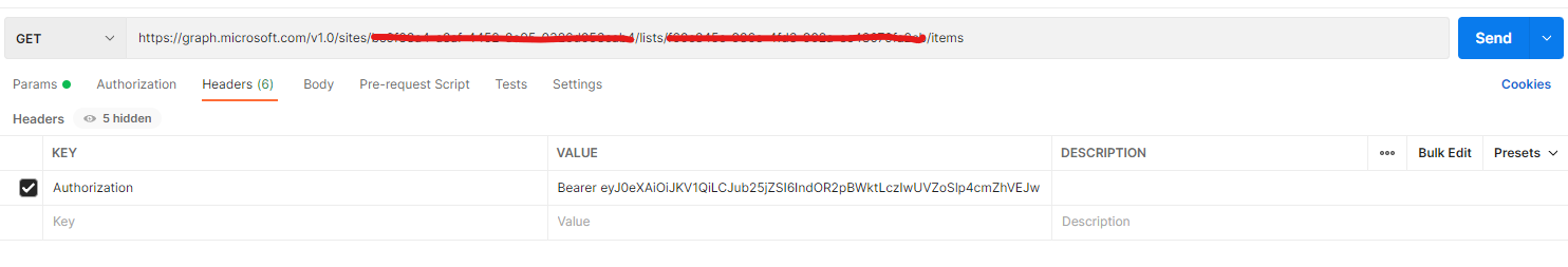

    Set the request Header like following and retrieve the datas
    KEY	                VALUE
    Authorization	Bearer {AccessToken}

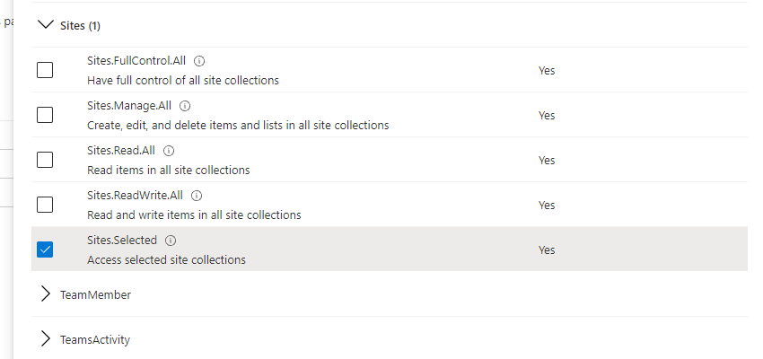

  2. LPFreelance 1 Reputation point
    2022-03-07T13:42:03.893+00:00
    Hi @RaytheonXie_MSFT ,
    As a developer, I'm trying to implement a limited access to a SharePoint site using application level authentication (without a user).
    I followed the step as you describe, but I could not grant a read permission (point 2).
    Before sending a POST request to add a read permission, I've tried a GET request:
    GET https://graph.microsoft.com/v1.0/sites/{sitesId}/permissions
    When executing this request (within Graph Explorer), the response is (Forbidden - 403):
        "error": {
            "code": "accessDenied",
            "message": "Access denied",
            "innerError": {
                "date": "2022-03-07T13:02:42",
                "request-id": "...",
                "client-request-id": "..."
    I've asked an administrator to do so.
    However, the tool respond with:
    You need to consent to the permissions on the Modify permissions (Preview) tab
    And in this tab, the following line shows up:
    Permission: N/A
    Description: Consent description unavailable
    This is somewhat not helpful, and clicking on "Consent" button opens a popup with following error:
    Message: AADSTS70011: The provided request must include a 'scope' input parameter. The provided value for the input parameter 'scope' is not valid. The scope N/A openid profile offline_access is not valid. The scope format is invalid. Scope must be in a valid URI form <https://example/scope> or a valid Guid <guid/scope>.
    Any help would be much appreciated.
    Best regards.
  3. LPFreelance 1 Reputation point
    2022-03-07T14:20:52.34+00:00
    Well it finally worked, asking the administrator to add "Sites.FullControl.All" consent in Graph Explorer, using "Select permissions" in "..." button.
    If I may, this complete procedure is not explicitly described in the official documentation of the Microsoft Graph Api. It would have been much appreciated.
    Furthermore, from Azure AD portal, in an application when selecting "Sites.Selected" permission, the tooltip says:
    Allow the application to access a subset of site collections without a signed in user. The specific site collections and the permissions granted will be configured in SharePoint Online.
    This last part might directly redirect to a detailed solution instead, or explicitly informed that Sites.FullControl.All is mandatory.
