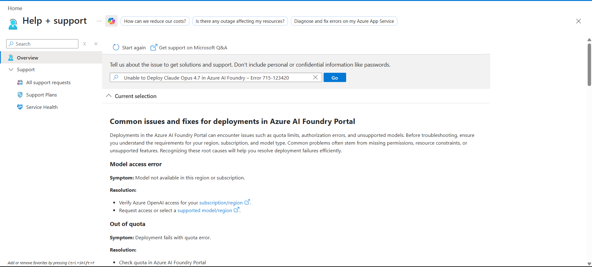

Hello Azure Support,
I am contacting you regarding an issue in Azure AI Foundry where I am unable to create a deployment for the Claude Opus 4.7 model.
I currently have a paid Azure subscription with Pay-As-You-Go enabled and have also purchased a $30 plan, so I believe my account should qualify for access to deploy this model. However, every deployment attempt fails with the following error:
[Removed PII]
Error Code: 715-123420
Message: "An error occurred. Please reach out to support for additional assistance."
Could you please investigate this issue and help enable deployment access for the Claude Opus model on my account or subscription?
Thank you for your assistance.

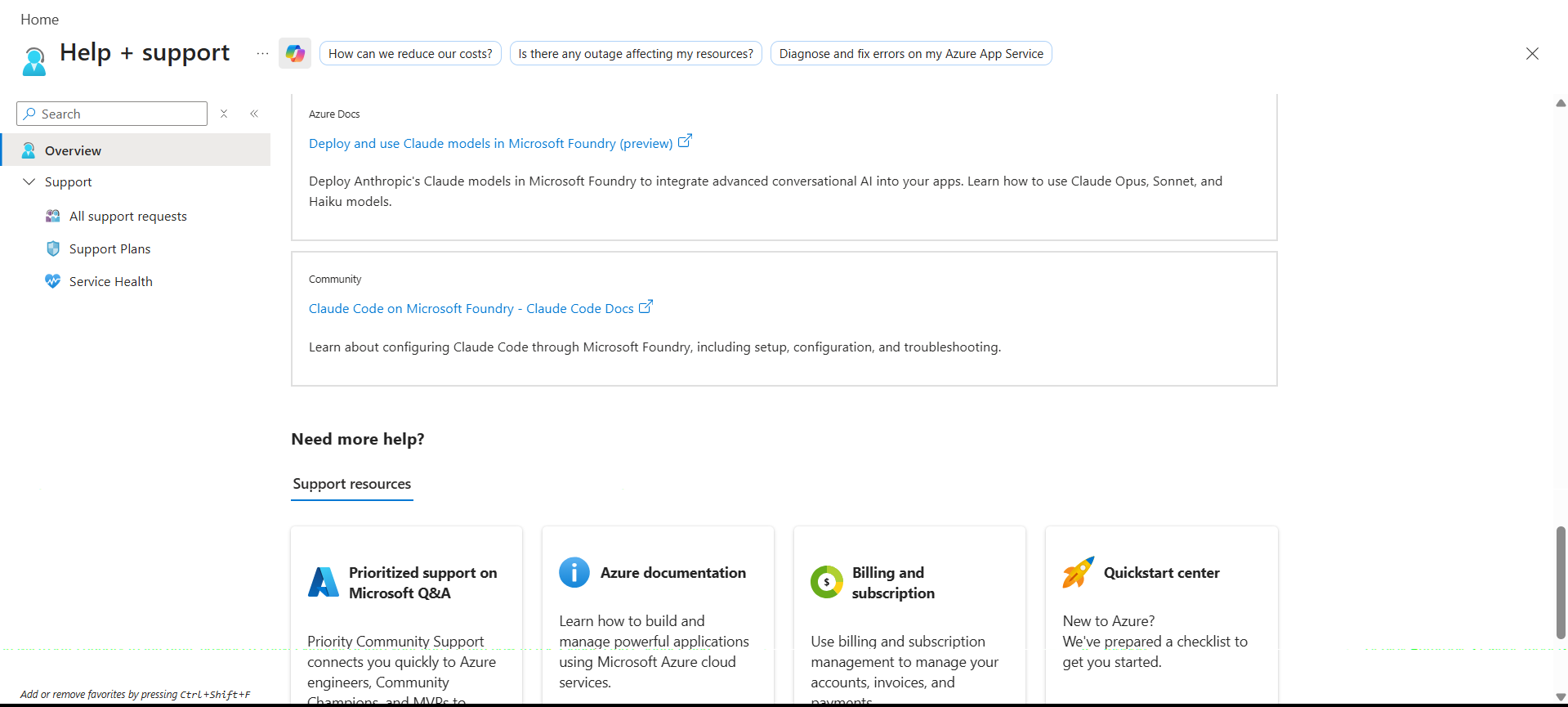

    Step 5: Open an Azure Support Ticket — most important step
    Since error code 715-123420 explicitly directs you to contact support and cannot be self-resolved, please raise a formal ticket. Go to:
    Azure Portal → Help + Support → New Support Request and fill in:
    • Issue type: Technical
    • Service: Azure AI Foundry / Microsoft Foundry
    • Problem type: Model Deployment Issues
    • Problem subtype: Unable to deploy Anthropic / third-party model
    • Severity: B (Moderate)
