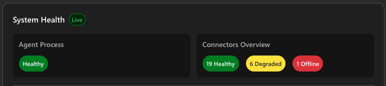

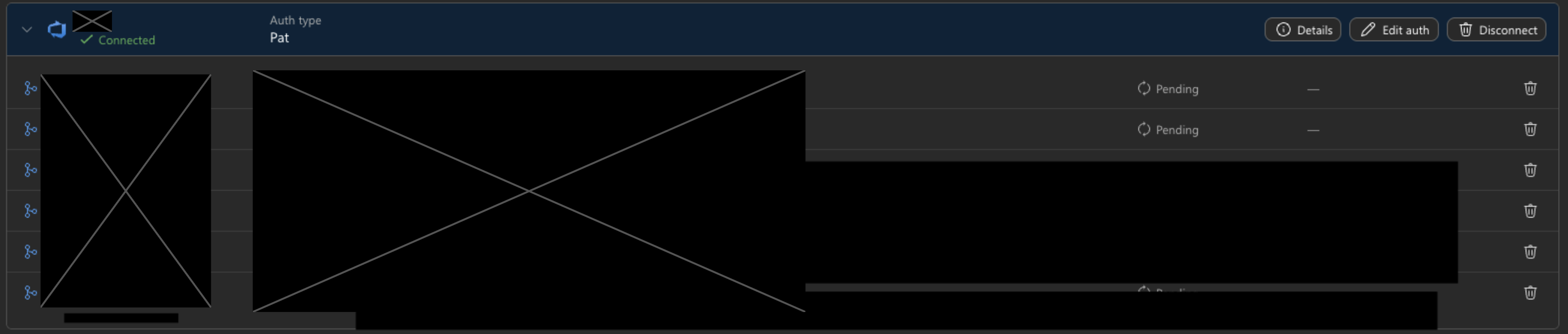

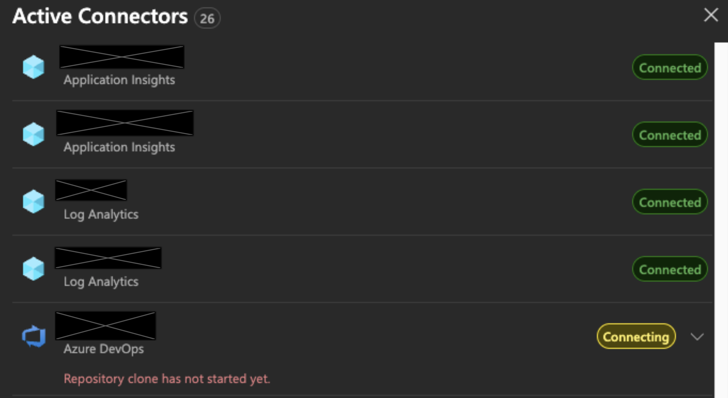

I am having trouble connecting my SRE Agent to my Azure DevOps Repo. The connection is ok but the status has been stuck on pending and connecting for more than a day. It also says that repository cloning has not started yet.

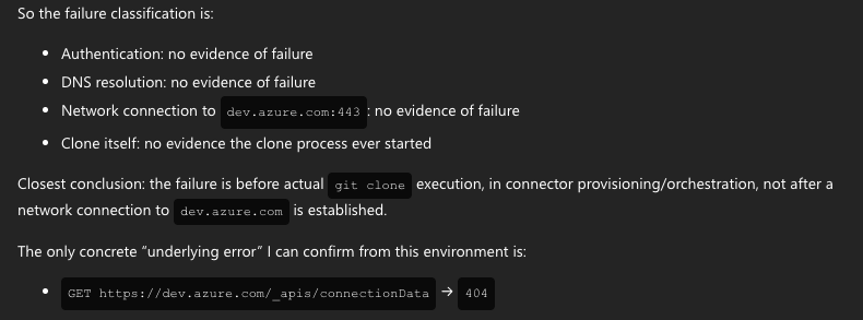

    Even when using a Personal Access Token (PAT) with full permissions or my own Azure DevOps account, I consistently receive the following error when the agent attempts to create a pull request via chat.
    The repository changes are complete, but publishing to Azure DevOps is blocked because the agent cannot access the required Git credentials in the current terminal session. As a result, it requests the minimum required permissions to complete the pull request creation.
    fatal: could not read Username for 'https://dev.azure.com': No such device or address

    Thank you for reaching out on the Microsoft Q&A portal. Based on your screenshots and description, your Azure SRE Agent has successfully established an initial connection, but the repository clone is stuck in a "Pending" state and indicates "Repository clone has not started yet."
    This behavior typically occurs when the identity used for the connection (Managed Identity, OAuth, or PAT) can authenticate to Azure DevOps, but lacks the explicit project-level or code-level permissions required to initiate a clone.
