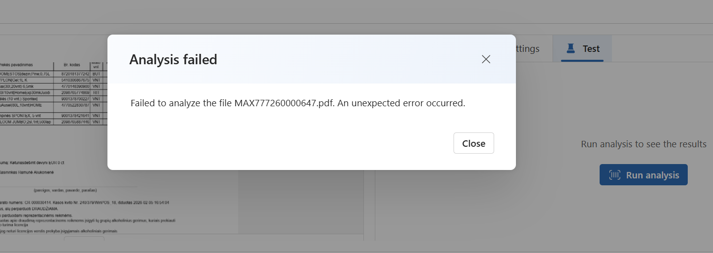

Starting today, Content Understanding Studio has been returning errors when calling analyzers. The issue occurs regardless of whether the analysers are called from the user interface or via the API. No changes have been made to the configuration.
"id": "dd606eef-a2a4-4d4e-ad0f-538a1b0e35ba",
"status": "Failed",
"error": {
    "code": "InternalServerError",
    "message": "An unexpected error occurred."
"result": {
    "analyzerId": "projectAnalyzer_1776748484926_373",
    "apiVersion": "2025-11-01",
    "createdAt": "2026-06-10T12:11:28Z",
    "warnings": [],
    "contents": []

    The AI response wasn't helpful. I tested it in a different region, and the same issue persists.
    I believe the issue is easily reproducible with any configuration.
