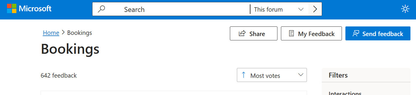

    If this monthly recurring behavior would be valuable for your scenario, you may also want to submit feedback for future product development. Feedback submitted through Microsoft’s feedback channels | Bookings is a good way to let the product team know there is demand for this type of scheduling option. This is especially helpful when the current behavior appears to be by design rather than a documented configuration issue.
