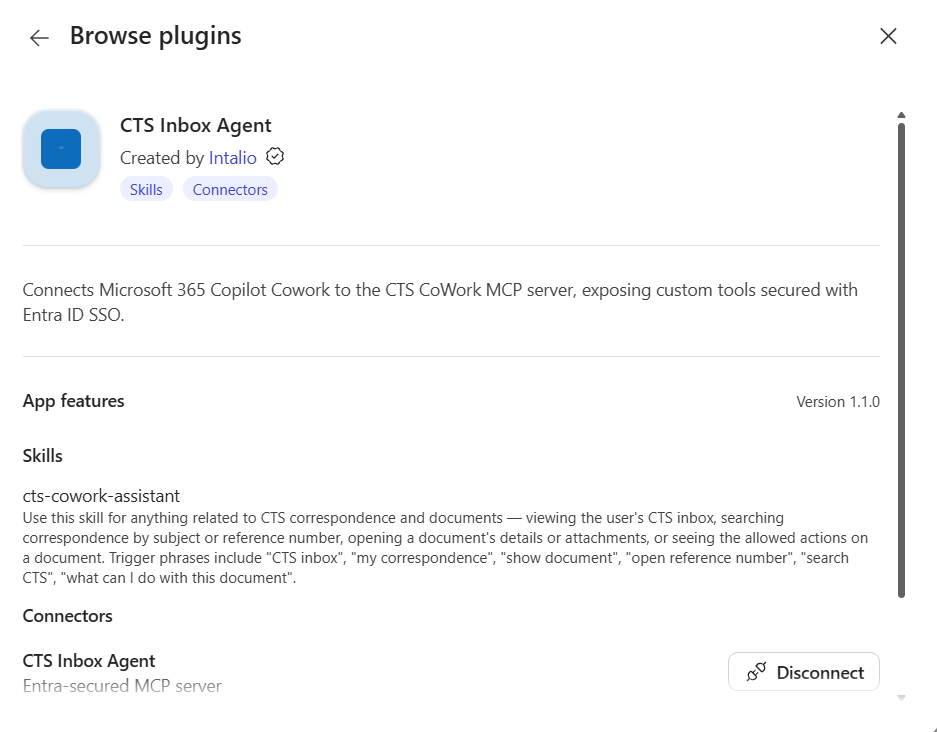

  1. In Sources & Skills, the connector appears and "Connect" / sign-in completes successfully (Entra consent succeeds — no AADSTS error).
  2. Skills load in chat.

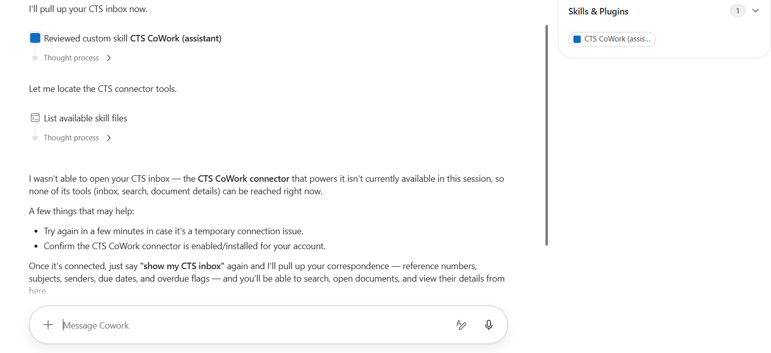

  3. When the user asks something that triggers a connector tool, Cowork responds with a message like "I'm unable to reach the connector — it isn't responding in this session."
  4. Server-side during the failure: the connect/validation phase reaches the server, but chat-time tool invocations do not arrive at the server as authenticated calls. (The server logs every request, including unauthenticated ones, which it correctly rejects with 401 while EnforceAuth = true. During the chat-time failure, no valid authenticated tool call is received.)
