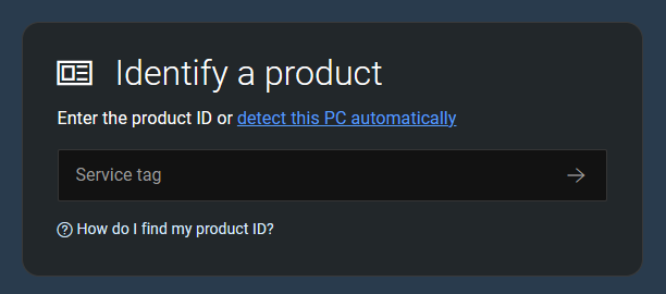

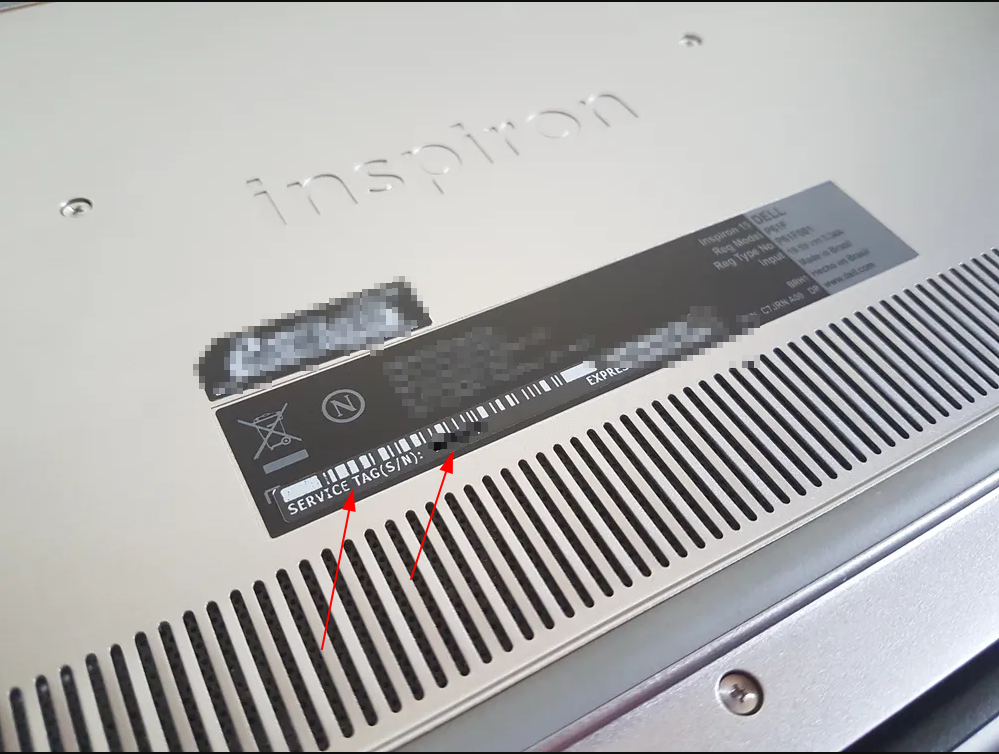

    Regarding the battery purchase, I can't recommend a specific one, but you can go to https://www.dell.com/support/home/en-ae > In Service Tag, enter your notebook's Service Tag, which is located on a label on the back of the notebook labeled Service Tag (ST).

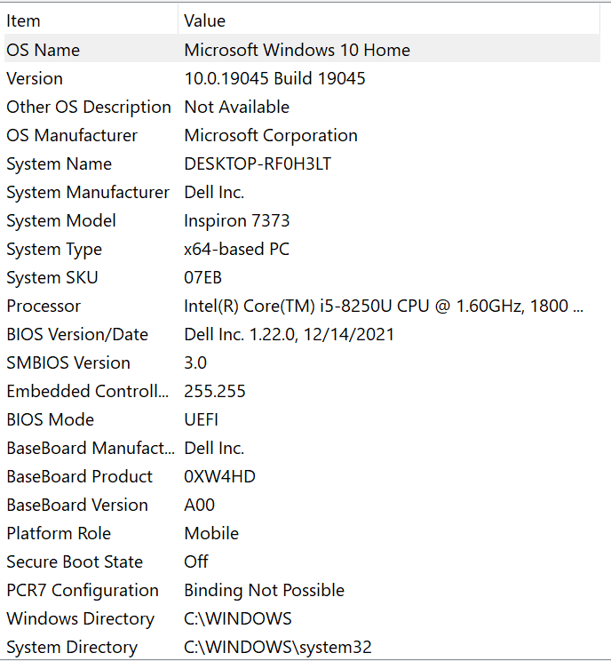

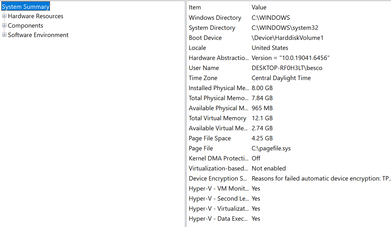

    • Press WINDOWS + R > Type "msinfo32" > In System Summary, send me a screenshot.
    When you replaced the battery, the BIOS probably reset. When the BIOS is reset, BitLocker is activated and the PIN becomes unavailable, as both depend on the TPM, which is reset with the BIOS.
    Even with the PIN unavailable, are you able to log in using another login method?
