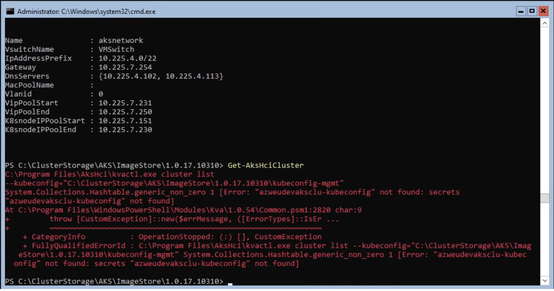

  4. Sunil Singh Rawat 0 Reputation points
    2023-06-15T13:21:31.5666667+00:00
    Hi Everyone,
    while deploying the AKS workload hybrid cluster on Azure stack HCI,
    I am getting attached error. Can someone please help me.
