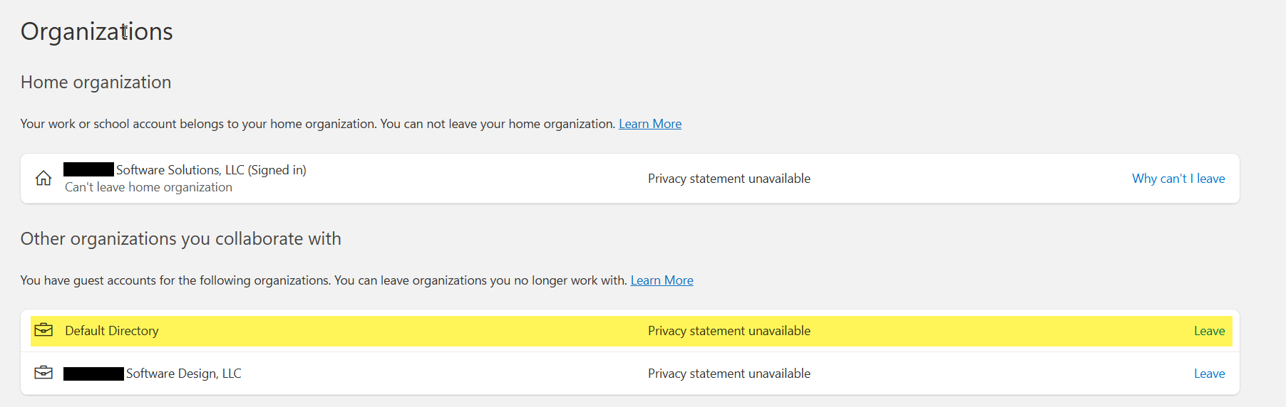

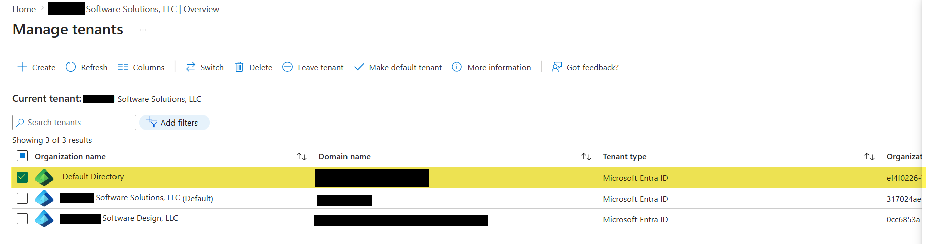

    I am listed as a guest on that organization, but I am the one who created it, I'm the administrator. User's image User's image
    It was created back when a enrolling with personal account was allowed and even recommended. That has since changed and I can no longer get at that account. Visual Studio seems to always want to validate against that tenant. I'm not sure if it is just trying to validate every tenant, or if this is somehow a primary. I would love some advice about how to create a support ticket for this situation. None of the standard choices seem to relate to this topic, unless I just don't understand the vernacular well enough to realize they do.
