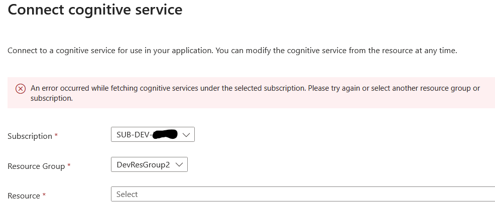

I'm not able to add a cognitive service for 2 days in a row. It either just loads without reaching a result or it shows this error.
Advice?

From your screenshot, the portal is failing at the point where it tries to enumerate the available Azure AI/Cognitive Services resources:
"An error occurred while fetching cognitive services under the selected subscription."
Since you've been seeing this consistently for 2 days, it's unlikely to be a transient browser issue alone. Here are the most common causes, in order of likelihood.
Go to Azure Portal > Azure AI services (or Cognitive Services) and confirm:
  • The resource exists in DevResGroup2.
    • The resource is in the same subscription you've selected.
    • The resource status is Running (not deleting or failed).
If no Azure AI resource exists, the dropdown cannot populate.

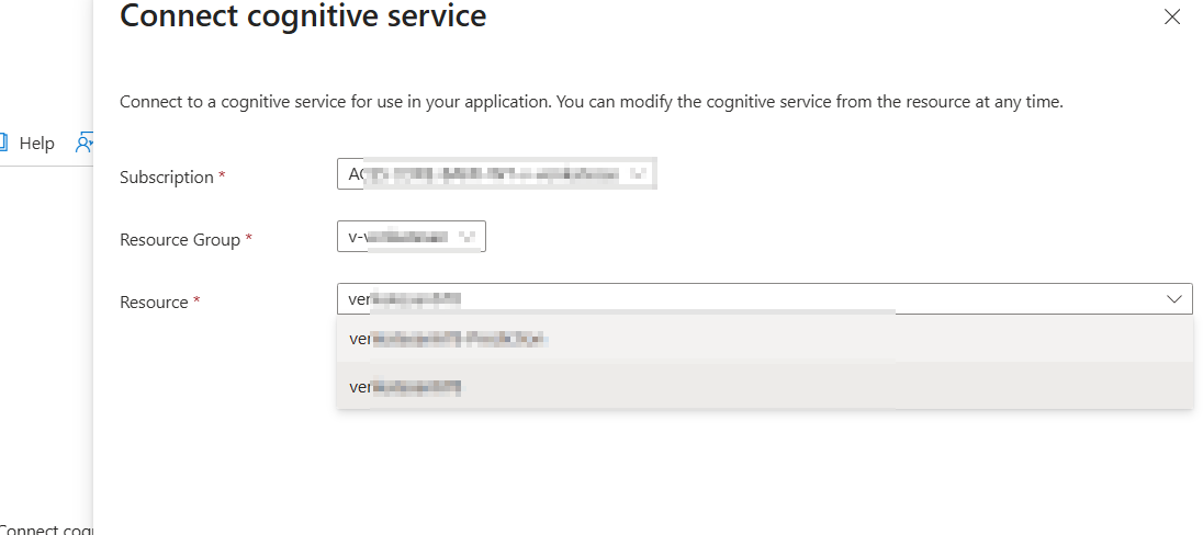

In my environment, I am able to see the Cognitive Services resource when I try to connect it with the Communication Services resource, as shown in the screenshot below.

**Update:
**As discussed, you are receiving a 429 (Too Many Requests) error, which appears to be related to your Azure subscription limits or quota.
We recommend raising an Azure Support request for further investigation into the subscription and quota-related limits. Once the subscription issue has been reviewed, please let us know, and we will be happy to assist further if needed.
