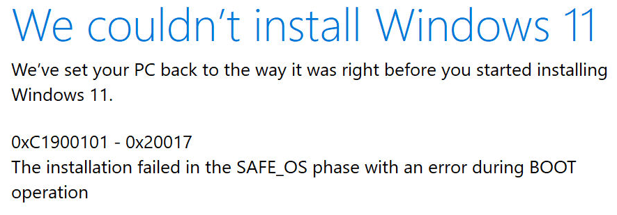

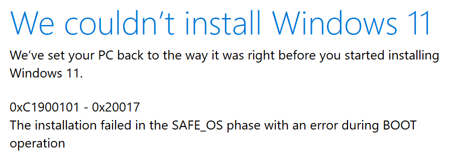

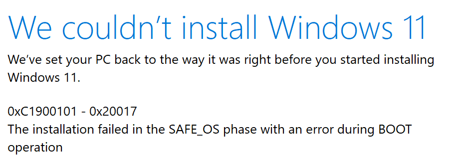

It is still disturbing that I cannot do an in-place install ... but I think that will have to wait for another time as I am getting behind on the things I need to edit
