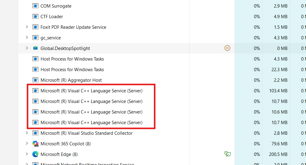

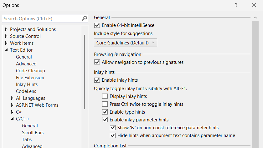

    First, IntelliSense is a core text editor feature in Visual Studio, so please make sure all IntelliSense-related options are enabled in Tools > Options, especially 64-bit IntelliSense. This setting is particularly important when working with large solutions that contain many projects and modules.
    Next, open Task Manager and look for the process called Microsoft (R) Visual C++ Language Service while your project is open. After saving a file, check whether this process is still running. If it stops unexpectedly, try running Visual Studio as an administrator and repeat the same test to see whether the behavior changes.

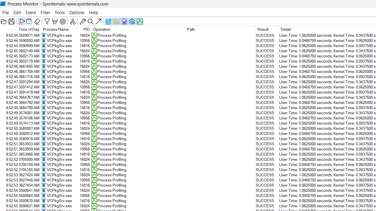

    I also found that IntelliSense appears to work by continuously reading and analyzing source files in real time to provide code suggestions and navigation features. Because of this, anything that interferes with file access can affect IntelliSense functionality. Since you mentioned that your environment uses enterprise security or encryption software, it is possible that a security policy or protection mechanism is preventing IntelliSense from accessing the files it needs.

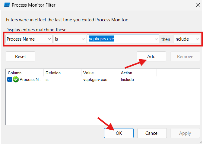

    To investigate further, please download Process Monitor and monitor the vcpkgsrv.exe process while reproducing the issue. Pay attention to the file access results. You can filter like this:
    If you see operations returning a status other than SUCCESS, that would suggest something is blocking or restricting access to the files. User's image
    In that case, I recommend reviewing the security policies or protection software in your environment with the appropriate team to determine whether they are interfering with IntelliSense.
