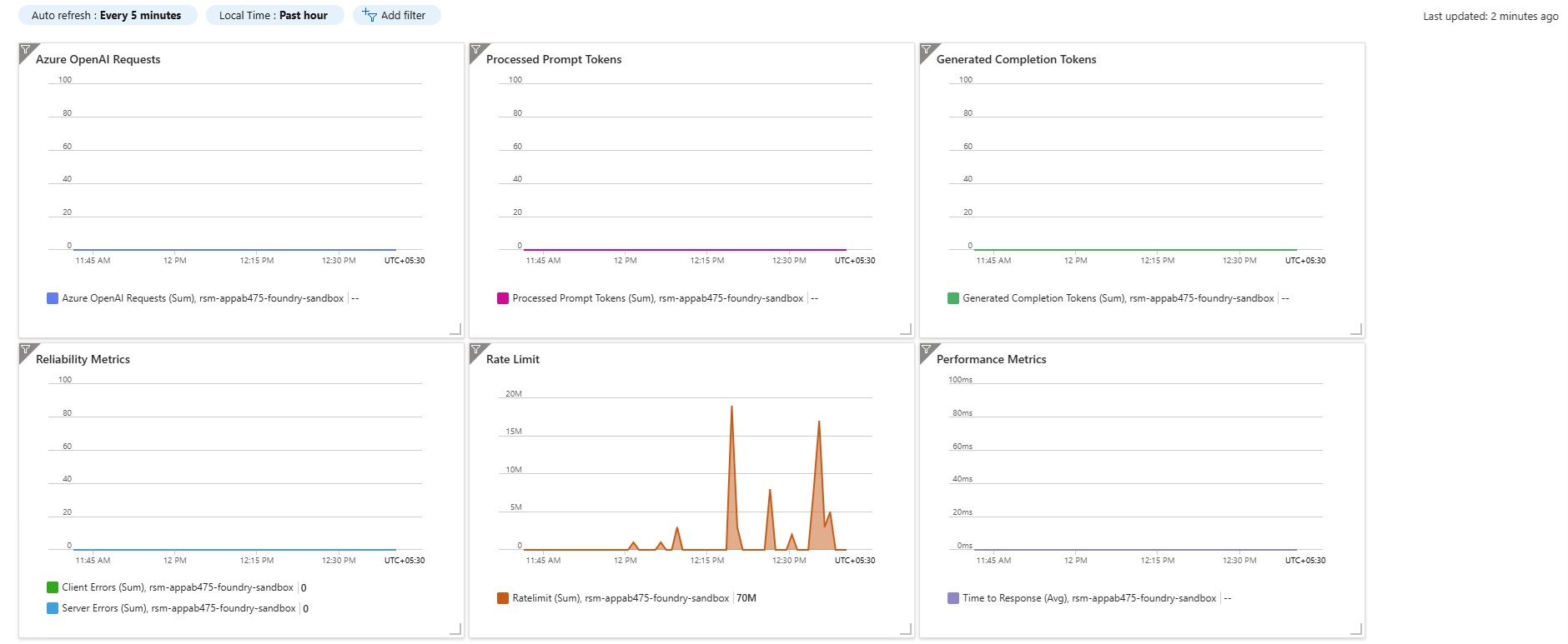

Hi everyone,
I'm new to Azure AI Foundry development and would appreciate some guidance.
I created an AI agent using the Azure AI Foundry SDK in Visual Studio Code and deployed it to Azure AI Foundry using a GPT-5.4 model. It is working as expected, but I have been assigned a task to validate whether the deployment has sufficient quota and throughput before production.
Since I'm new to this area, I'm not sure where to start.
Could someone help me understand:
  • What is the recommended approach for validating an Azure AI Foundry deployment?
  • How can I measure prompt and completion token usage?
  • How can I monitor Tokens Per Minute (TPM) and Requests Per Minute (RPM)?
  • How should I perform load testing (for example, simulating multiple concurrent users)?
  • What metrics should I monitor to determine whether the deployment can handle the expected workload?
  • How do I know when the current quota is insufficient and a quota increase is required?
  • Are there any Microsoft Learn articles, sample scripts, or best practices that demonstrate this process?
Any beginner-friendly guidance or documentation would be greatly appreciated.
