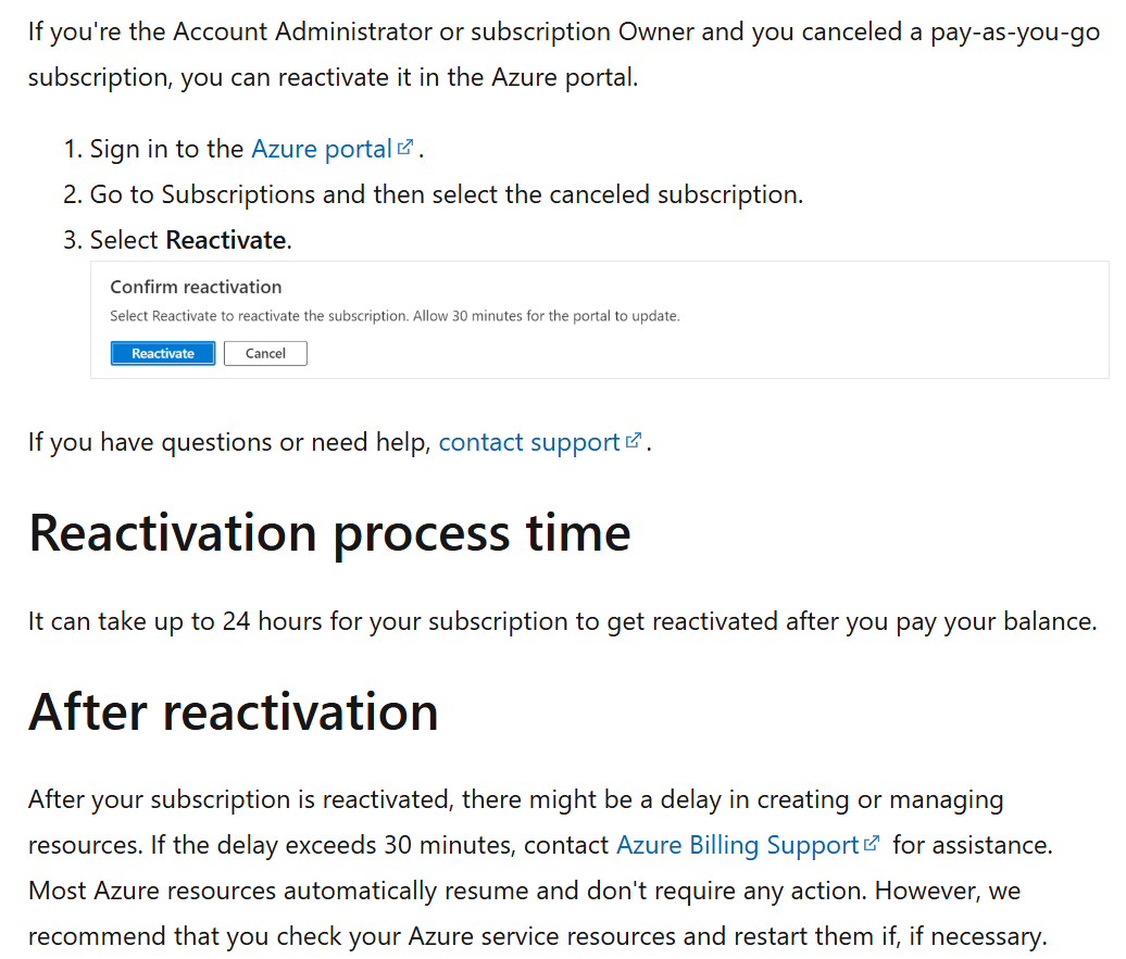

    Please could you let us know if you have tried re-activating your subscription.
    https://learn.microsoft.com/en-us/azure/cost-management-billing/manage/subscription-disabled?sharingId=99416360D04B6839#the-subscription-was-canceled
    Create domain resource with same name and try to recover your App service domain.

    Since you just deleted it yesterday, have you tried re-activating your Azure subscription, restoring your App Service Domain (must be in same resource group and same subscription), and then once that is complete, obtaining authCode?
    Reactivate a disabled Azure subscription - subscription was canceled
    https://learn.microsoft.com/en-us/azure/cost-management-billing/manage/subscription-disabled#the-subscription-was-canceled
