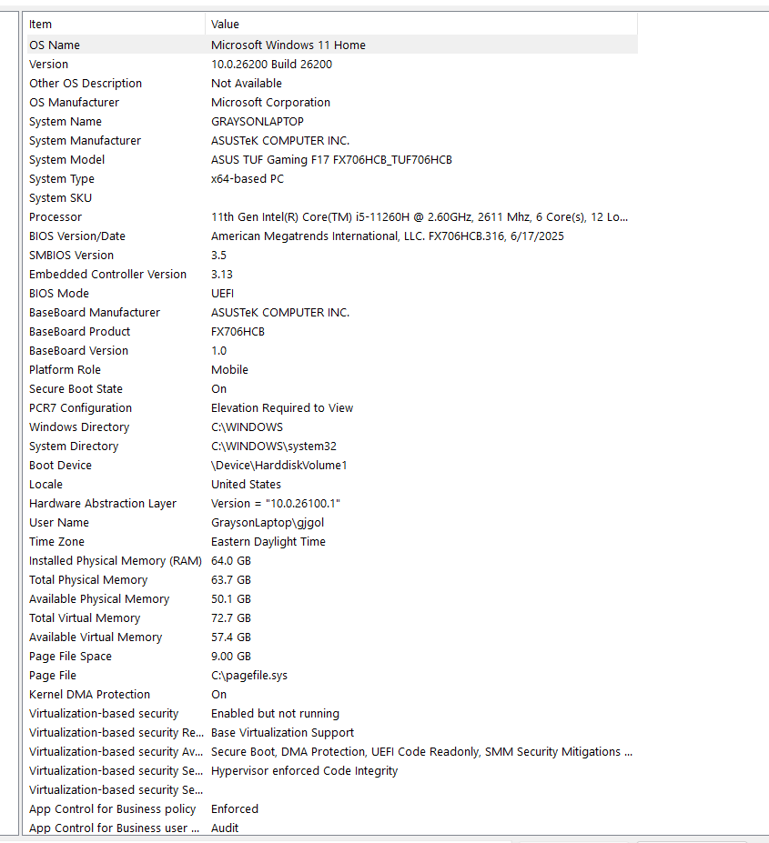

Here is the msinfo.exe screenshot.
Also,
Also here is the minidump file https://drive.google.com/file/d/1lDjB7XptUPHxV0Lkk1R2EAg5qlwyBgZO/view?usp=drive_link

I have a Asus FX706HC laptop that is about 4 years old. I am all of a sudden getting these errors Stop Code Page_Fault_In_Nonpaged_Area (0x50) and IRQL not less or equal. The computer reboots and comes back up into Windows normally. I also cannot update Windows through updater. The latest July security patch will not install and gives error code 0x80240035. I have run memtest86 and have no issues with the RAM. I have also completed wiped the computer and reinstalled from a Microsoft image via USB.
I have Windows 11 Home 25H2.
Also,
Hi ,
Search for msinfo32.exe in the search bar, take a screenshot, and post it here so we can see the correct laptop model or desktop configuration.
Access the c:\windows\minidump folder, copy the files to your desktop, then upload them to OneDrive or Google Drive and post the link here for analysis.
