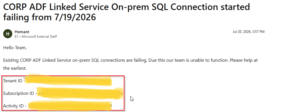

Hello Team,
Existing CORP ADF Linked Service on-prem SQL connections are failing. Due this our team is unable to function. Please help at the earliest.

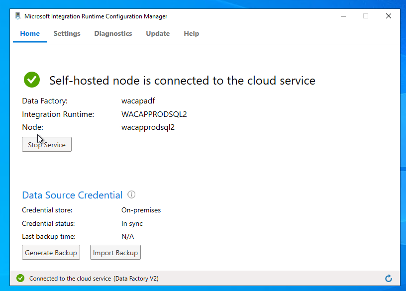

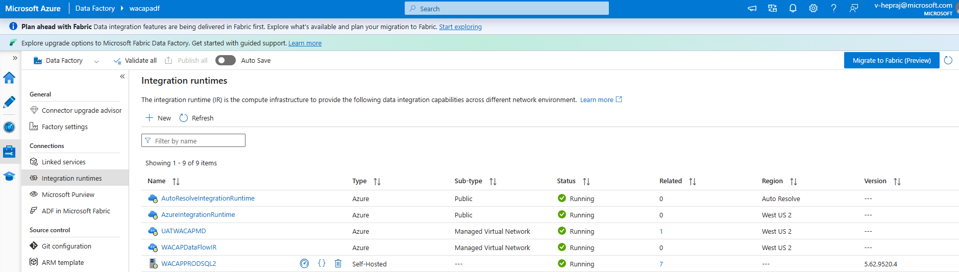

    3. Restart the self-hosted IR service and confirm the IR is online and healthy in:
    ADF > Manage > Integration runtimes
    1. Run the self-hosted IR diagnostic tool from the IR machine to test connectivity to the SQL Server.

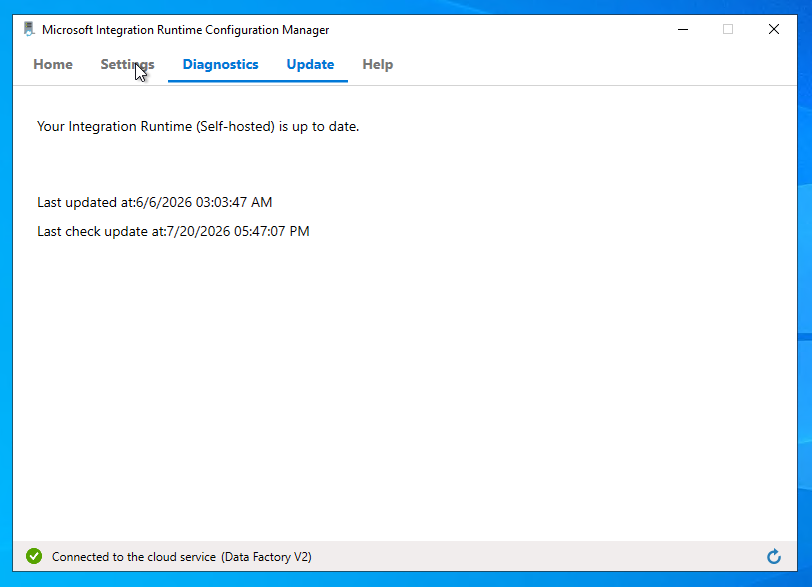

    2. If this started recently, also check whether the IR version, SQL Server TLS/encryption settings, or linked service connector version changed. As a quick test, you can create a temporary linked service with minimal settings to isolate whether the issue is credentials, IR, or SQL Server connectivity.
