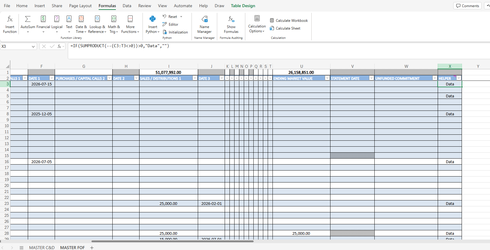

Hello! I have a spreadsheet where one tab is pulling information from another tab on the same excel. I need to be able to sort, filter, and add/remove lines without the formula data changing on tab 2. I had everything linked, but then when I added additional lines the formulas for everything below the new lines got shifted and messed up. I need to be able to lock everything so I don't have to keep redoing it. It's a massive spreadsheet. I have spreadsheets where it works fine and others where it doesn't. I am not sure what setting to change. How can I do this?
An example of the formula on tab 2 (MASTER FOF) that is pulling from tab 1 (MASTER C&D) is:
='MASTER C&D'!C6

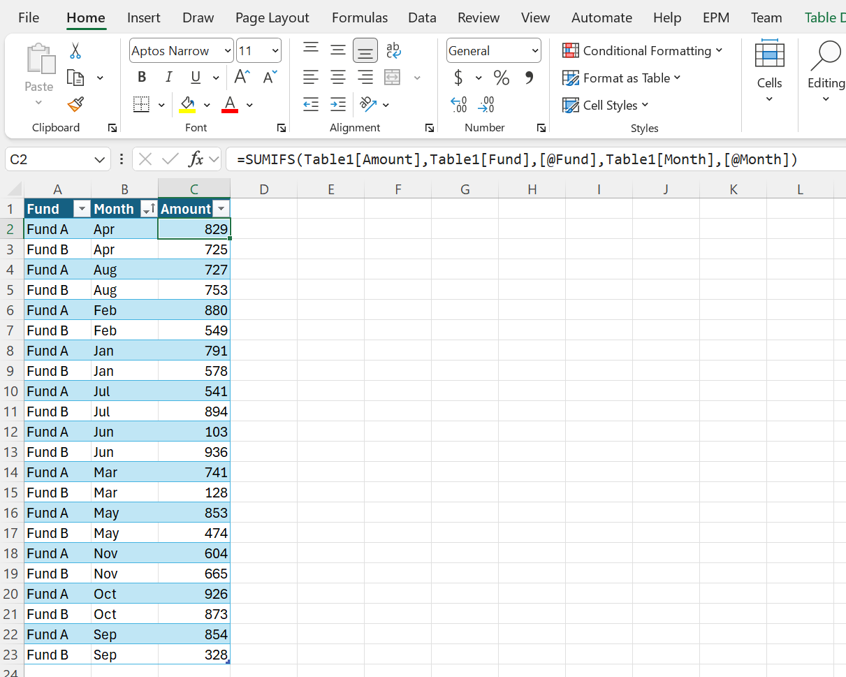

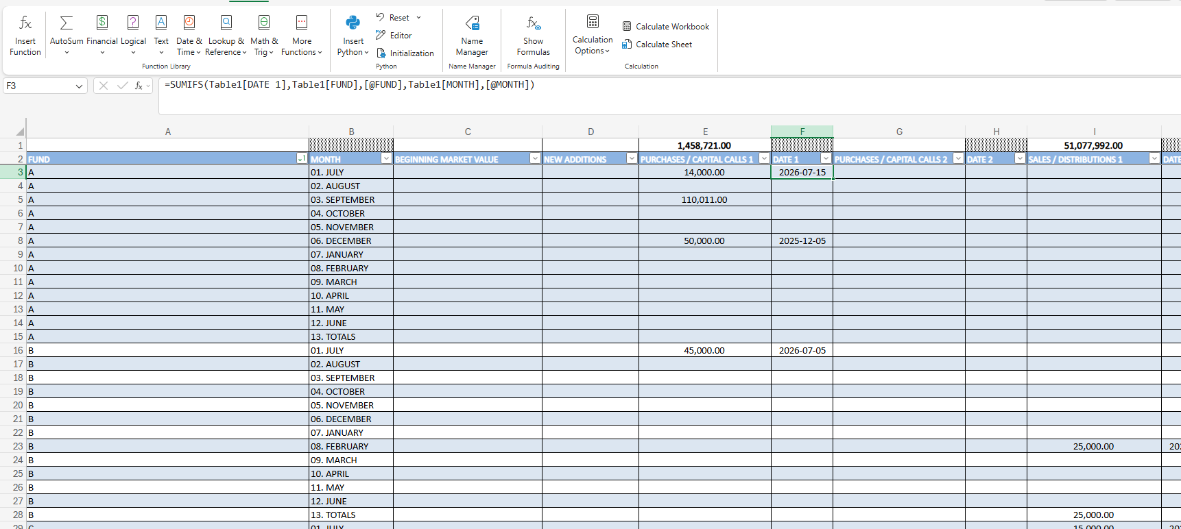

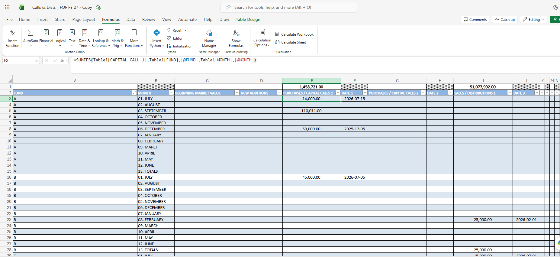

  2. Ashish Mathur 102.2K Reputation points Volunteer Moderator
    2026-07-21T22:49:06.6366667+00:00
    You should fetch data into Tabl2 from Tab1 based on some sort of lookup function.

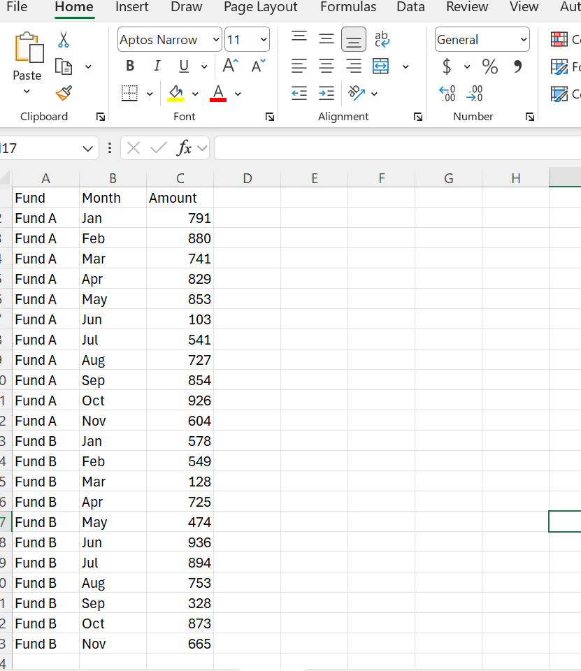

  3. Hendrix-C 19,970 Reputation points Microsoft External Staff Moderator
    2026-07-21T19:26:30.2933333+00:00
    Hi Megan,
    For the best possible assistance, may I confirm whether your expected outcome is
    • To have the formula on tab 2 always pull from a specific physical cell, like "always return whatever is in cell C6, even if rows are inserted" or
    • You want to have a relative cell reference, like the formula linked with a specific data so if it's sorted, filtered or in a different cell than C6 the formula still correctly references that data.
