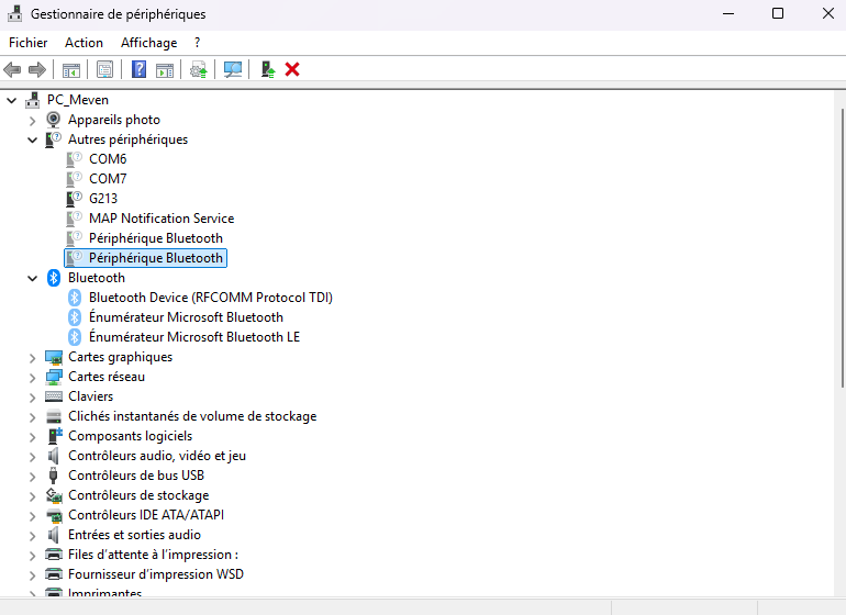

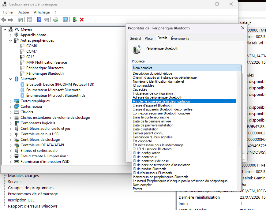

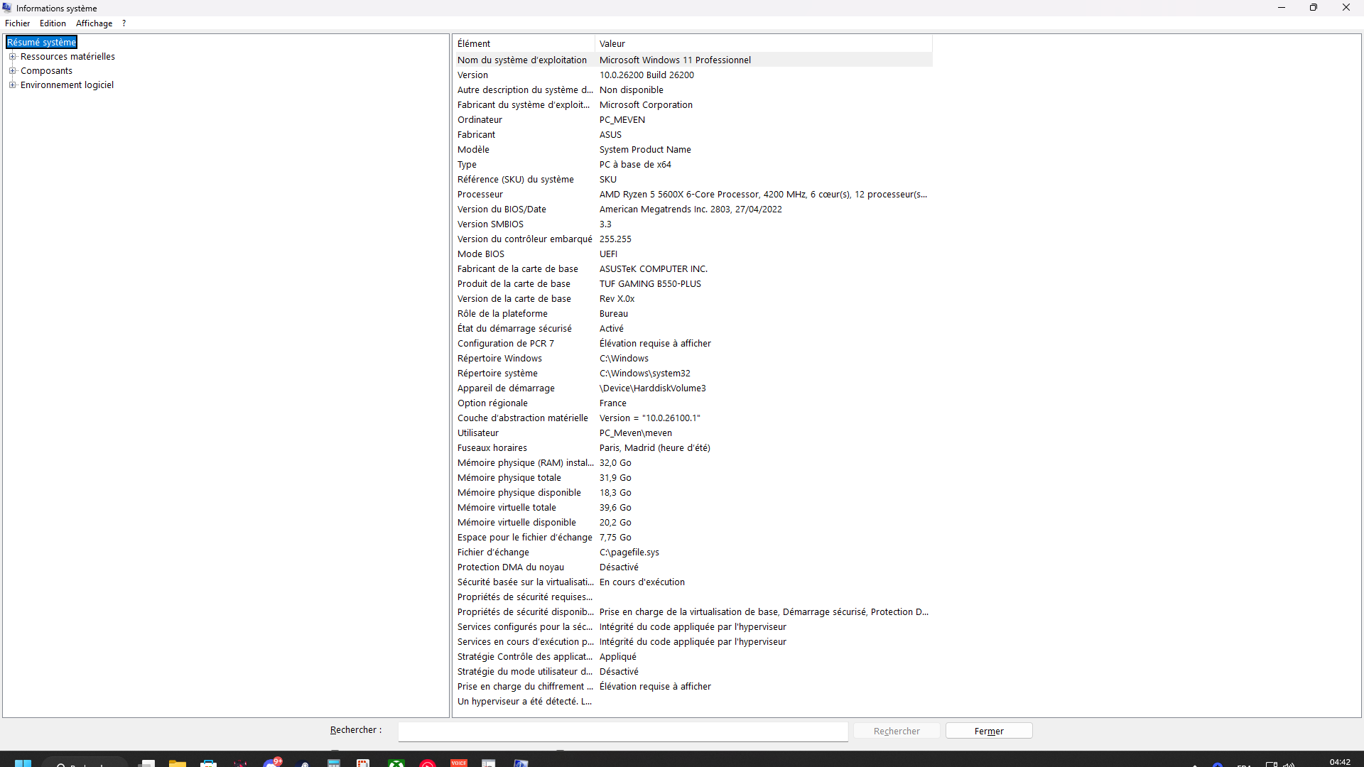

First, regarding those Hardware IDs starting with BTHENUM: those aren't actually your Bluetooth adapter itself. They are just records of devices you paired via Bluetooth in the past.
However, after a deeper look into the specs of those cards, your screenshot showing the "MediaTek Wi-Fi 6E MT7922" adapter gives the answer: since it's a Wi-Fi 6E chip, your card is the ASUS PCE-AXE5400 (the PCE-AX1800 is only standard Wi-Fi 6).

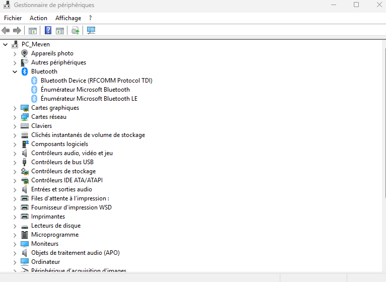

3 = Check Device Manager for USB Errors
Open Device Manager, but instead of checking Bluetooth, expand Universal Serial Bus controllers:
- Look for any item with a yellow exclamation mark (such as Unknown USB Device).
- If you see one, it means the hardware cable is detected, but the chip needs a driver reinstallation or a quick reset.
