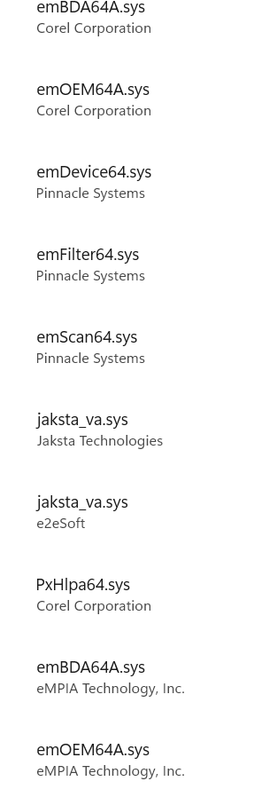

0xC1900101 errors are usually driver-related. Please upload the following setup log files to OneDrive or GoFile.io and post the link here:
C:\$WINDOWS.~BT\Sources\Panther\setupact.log
C:\$WINDOWS.~BT\Sources\Rollback\setupact.log
Add the files to a zip archive and upload it.
Enable Memory Integrity. To do so, go to Windows Security → Device security → Core isolation details → Memory integrity. If the page lists any incompatible drivers, please post a screenshot.
